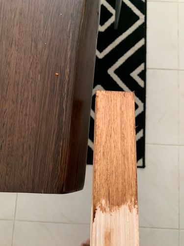

The next challenge is how to match this stain of the table (I know it is very very hard to tell from pictures). It is more black brown with a satin finish. The first picture is a comparison of the panel to offcut coated with one coat of merbau stain varnish. Any insight on this is also appreciated

It is going to be difficult to get a perfect colour match because you are working with different species of timber but comparing them in person will be the best way to go about it.
My suggestion is to take an offcut from when you're creating the live edge and bring it in store with you. There is usually a display board with the stains that you can put an offcut next to and compare the colours.

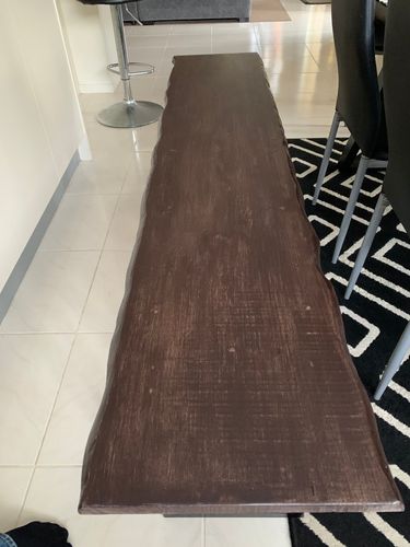

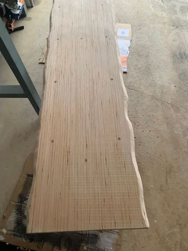

finally finished this today. Got the panel cut from Bunnings. And did 30 def cut along sides with jigsaw and then used wood carving disk to create the different shapes. Smoothed with sanding disc.

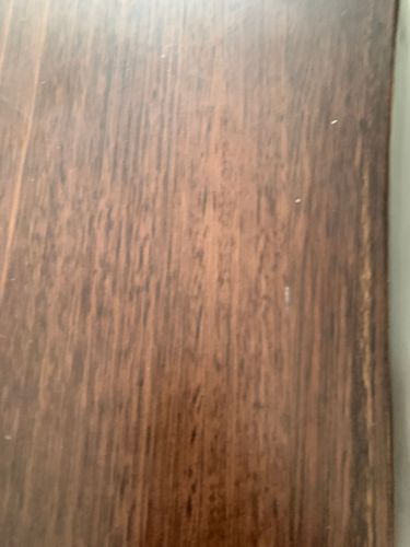

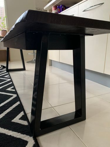

Went with screws from panel to support and filled the holes with the saw dust from cuts and glue from. It is still visible but that’s ok. Hope did a decent job with the stain matching with rich chocolate stain(5th pic)
only missing work is that the table finish more smooth and soft than the bench. Will probably a coat of something (will figure that out)

Thank you very much for sharing that update, the bench seat looks fantastic! I'm sure @JacobZ, @Dave-1 and @MitchellMc will be happy to see the results.
Good Morning @J-P
Now thats a solid looking bench seat!
Looks good and teh colouring looks a match ![]()
Did you put something like these under the feet Surface Gard 22mm Black Round Rubber Bumper - 6 Pack ?
I like how you have sanded it back so no "ouchies"
Nice Job.
Hi Dave - yes I put some thick felt to avoid contact with floor while moving. I spent good chunk of time in sanding because the bench would be at knee length for people and don’t want them to get a cut or scrape

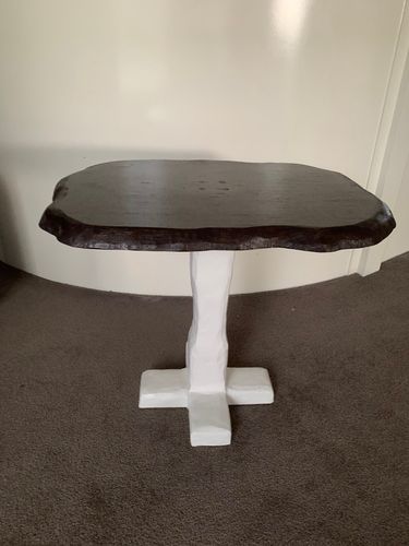

Hi @J-P,
Thanks for sharing the stool you made to go along with your original bench seat.
It looks great. Hopefully you get some good use out of it in the future.
