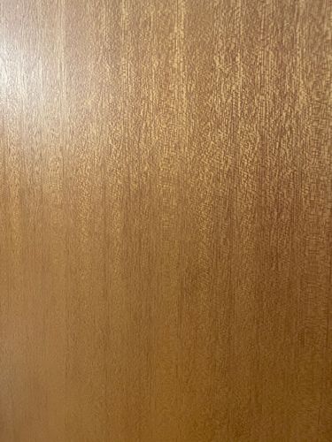

hi all. I’m trying to colour match a meranti veneer door from the 1970s/80s. Seems to have been in wide use and is a golden honey colour. If you know it, do you have  any advice on a product to that may suit? Cheers, Steven

Hi Jacob. I have two doors that both need touching up. I’d like to keep the same colour and do am lookjj in ng for a tinted varnish. I’m aware of the colour charts, and also that it depends on the wood it’s applied to. I asked the question in case someone has colour matched a 70s meranti door with a tinted varnish. These doors were not uncommon and so am trying my luck.

Is there a chance of a better photo to show what you mean by touch up? I think it will be hard to touch up smallish areas and it may be worth while considering to sand back and redo depending on how small the area is.
I remember those styled doors and how consistant the colouring was, a patch I think would be hard to feather in.

Thanks Dave. I also suspect it will be difficult. I’ve decided to sand back the door and will colour match to other doors using the relevant colour chart.

There is a potential chance that by simply applying with a clean rag a best match lightly in the worn areas followed by a full door clear coat that the patches may blend in to a very acceptable level. I had a similar issue with my folks Parker furniture arms, which came up pretty good in the end. You will need to use an oil base to match what they used in the 70's.
