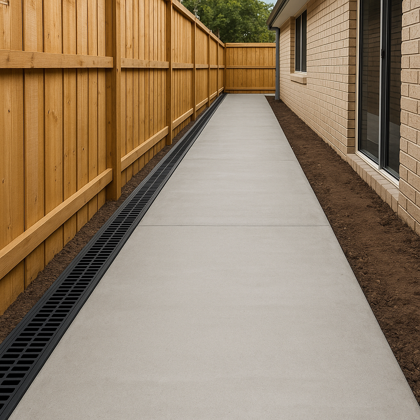

Here are some of the most important aspects when building your concrete walkway:
  • It must not cover the weepholes of your wall.
  • The walkway must be lower than your weepholes and not in-line with them.
  • The walkway must slope away from your house wall so that flooding and puddling will not occur near your house wall.
  • Appropriate drainage must be provided so that the water does not flood other properties.
  • Remember to assemble the walkway in sections so that it does not crack or break apart when movement occurs.
  • Most importantly, remember to provide a flat and level base for the slab.
I've placed a sample image rendered using AI to give you an idea of what it could look like.
