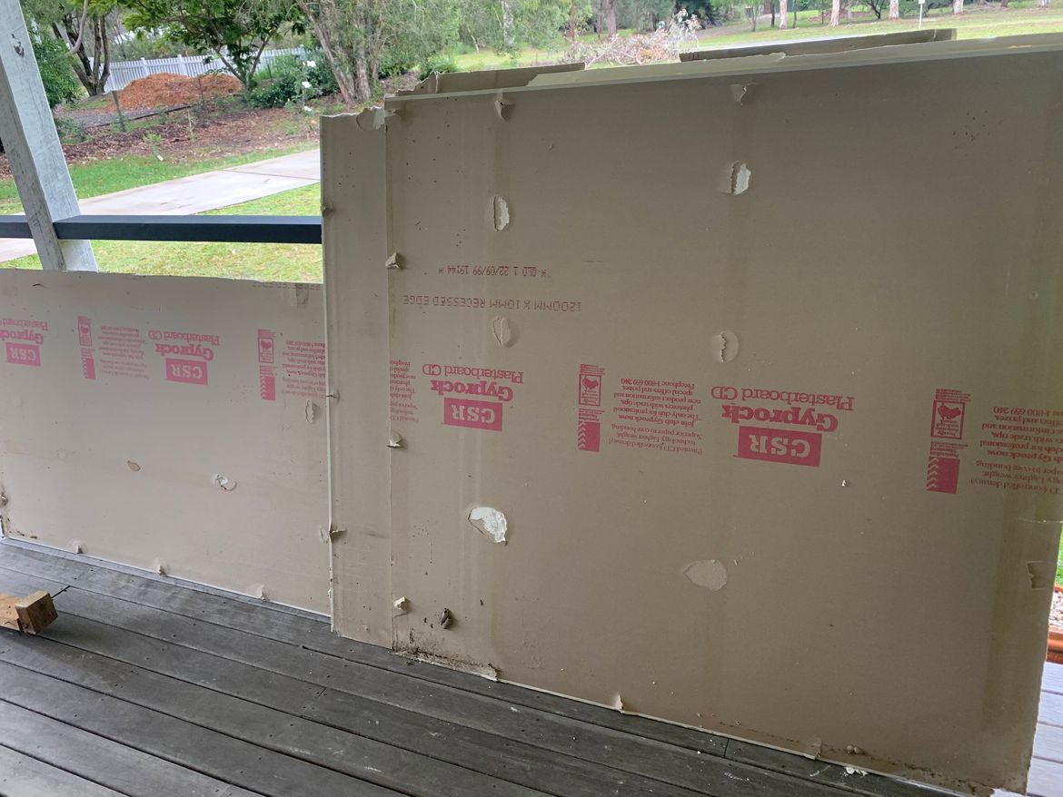

So how to do it properly, and safely?
- Rather than smashing everything up, take it apart. Bit by bit.
- Do it in the reverse order the builders put it together - skirting & architraves, cornices then plasterboards...
Does this make a difference? Well... have a look at the pic below.
Which do you think is easier and safer and cleaner and needs less tidying up... Carrying a nearly intact sheet out in one go or carrying out 5 bucket-loads of smashed up dusty sheeting?
Disassembling rather than demolishing also teaches you a lot about how a house is built. Useful stuff to know as you start rebuilding.
To be honest taking the time to remove sheets in big pieces doesn't actually take any longer. You lose some time on removal but you'll gain it back on the moving of waste & clean up.
Oh, and you'll also find you get a lot more in a skip bin when they're flat sheets.
