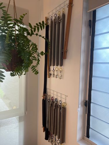

Trying to hang a small piece of metal pegboard directly to a narrow bit of wall.
it’s a tiny space and I need to hang Pilates springs.

Thanks Jacob, I took your advice and patched up those holes.
We went for the other wall instead and it’s working well.
Re: Drilling into brick wall to install hooks
Thanks, in the end I ditched the pegboard, and went for the simplest wall hook rack. Gave it a coat of white Rustoleum and installed it with wall plugs.
