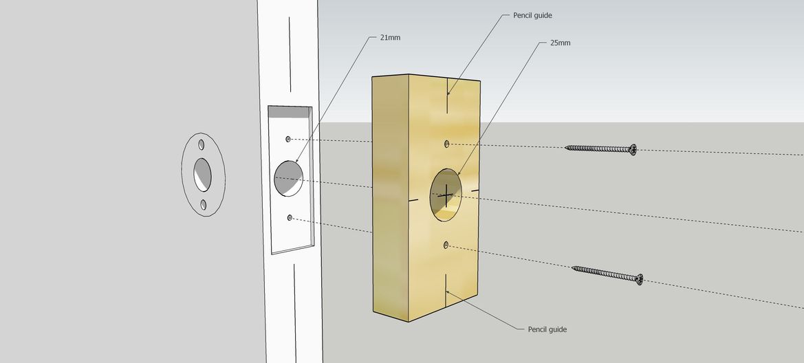

I suggest looking back into my colleague @MitchellMc's first suggestion about using an Irwin 25mm Speedbor Spade Drill Bit. In order for you to use this tool without jumping at the start of the old hole, you'll need to make a timber guide. The timber guide will hold the spade bit steady as it creates a new channel in the existing hole. This will also serve as an opportunity to correct the direction of the hole.  My number one tip is to make sure that the hole in the timber guide is dead centre to the old hole in your door. I've placed a sketch below for you to get an idea of how to set it up. If you have any questions about the guide, please don't hesitate to post them.
Make sure the holes are centred.Make sure the holes are centred.
