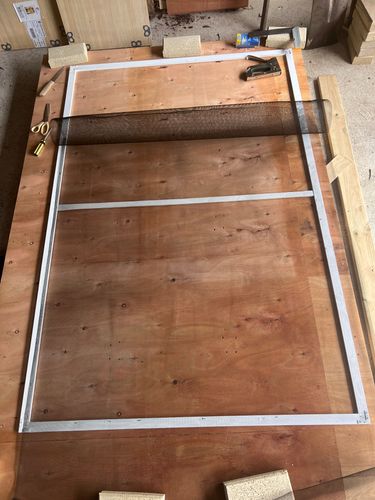

I’ve just made a wooden frame for a new flyscreen I’m making. However I’m having real trouble getting the aluminium fly screening to sit flat on the frame.

Thankyou for your reply. Yes I’m using staples.
It is for a large window 1500w and 1000high. I’ll be using a 1/2 spherical beading 10mm to cover the edges

It sounds like a similar issue to what I had the other week when stretching canvas on frames I'd built. Could you share an image of the frame and flyscreen currently so our members can see what you're working with? Let me know if you need a hand uploading images.
I'd recommend watching videos on how to install canvas on frames. They'll typically stretch it in a pattern to ensure there are no ripples. I've created an image below to illustrate one method. If you just try to fix it at random locations around the frame, you'll get a very inconsistent and distorted finish. If you follow the diagram and ensure the flyscreen is pulled taught but not overly tight before attaching following the numbers, by the end you'll end up with a very taught screen.

Just tried it your approach but simply won’t work. Any other ideas?
Could you please provide a few more details on the exact difficulties you are having @Martin4? Perhaps that would allow our members to provide relevant solutions.
I note that you are having trouble getting the fly screen to sit flat on the frame. Are you able to capture that with an image?
