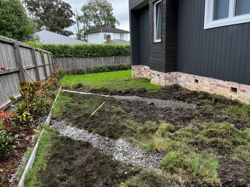

We ended up combining a couple of additional AG pipes with the regrading of the lawn on that side of the house. We still got some water this latest rain but it was much better than last time. We’re going to re grade some of the areas in the crawling space to direct the water towards the stormwater pit we built and I think that should be enough if we get the same rain again. Would a bit of wetness in the crawling space create an ongoing issue? Should we think of adding some fans in the long term? Do you have some guides on how to add those with a DIY approach?
thanks!
Vents covering before regrading
Two additional pipes
