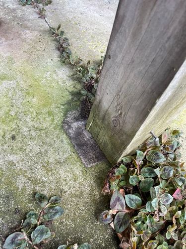

Who do I contact to assess and fix this carport post that is on a lean?
My car bumped into one of the front carport posts and now it is on a lean and out of the original position as shown in the picture. The pole itself does not look damaged but definitely needs to be adjusted back into position. The nails have come out halfway at the bottom of the post.
I am not familiar with the building process so needing some guidance on who to call to assess and get it fixed. Ideally, we are hoping to not need the whole carport replaced. att.LM-iMqx7vqUzSSJ7l2BcfztWaY_xh9iEhw1Z1MwXeTs.JPGatt.7DK1REpGByN5q9Y0LvPa81BgpZGG3t-JM80tKTDpMeg.JPG

Hi @MandyP,
It's a little bit concerning that there doesn't appear to be anything attaching this post to the ground. You may have accidentally revealed an issue that has been sitting there unnoticed for some time.
The repair wouldn't be too difficult, and a handyperson or carpenter should be able to assist.
They should use some acrow props to lift the carport up slightly so that they can move the post out of the way to install a post anchor using AnkaScrews or DynaBolts.
Once the post anchor is in place, the post can be slipped into the post anchor, the acrow props removed and then holes can be drilled out to install hex head galvanised bolts.
