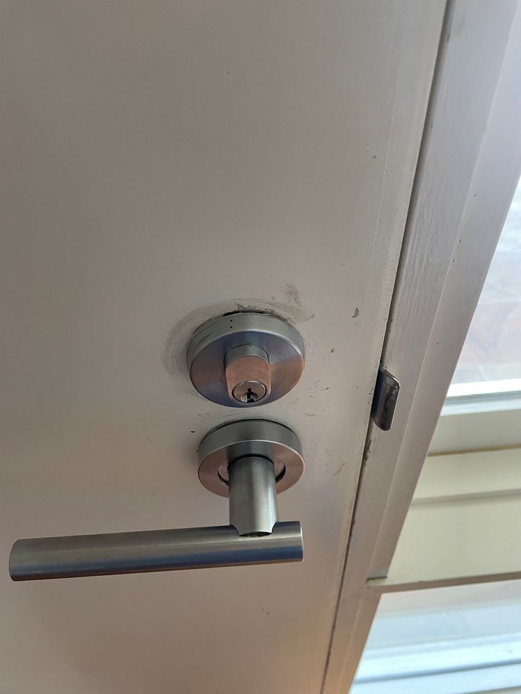

Hello Bunnings Workshop,
Can you please provide advice on fixing / tidying up the front door key lock in below photo.
Key questions - how to complete? what tools required?
Thanks in advance.
Shane
Key LockKey Lock
Re: How to fix front door key lock?
Hello @ShaneGty
I suggest removing the cover flanges of the door handle and the dead bolt. These will reveal the mounting screws underneath; you'll need a Philips screwdriver to tighten the mounting screws. Once the screws are nice and tight the door handle and deadbolt should look nice and straight. I propose using Selleys Sugar Soap Wall Cleaning Wipes - 25 Pack to remove the stains near the door handle and deadbolt assembly.
