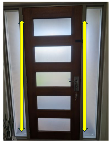

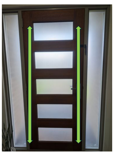

Great photos @Maxi . Now you will need to establish what's twisted the door of the jamb itself with a 1200mm level to see what's not plumb (vertically level).
From the inside check the left and right door jamb edges and then the door itself. Only open the door very slightly if need be to be able to rest the level on the right hand edge.
If the door jamb is twisted on the handle side, then all the trim will need to be removed to expose the cavity between the inside of the jamb and the timber frame. The securing nails will need to be cut, jamb straightened and the refined to the frame and trim replaced.
If the door is twisted, which is what I suspect, then you will need to replace the door itself.
Regards, Nailbag

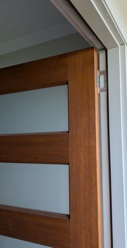

Hi @Maxi,
The twist in the door is certainly going to contribute, but looking at your last photo, it doesn't look to be enough for the door to stick out that far past the jamb.
Before replacing the door, you should check one last thing.
Open the door to 90 degrees and look at the gap between the door jamb and the door where the hinges are. See the below photo as an example.
You can see on my door that the gap between the door and the frame is not even between the middle and top hinge.
On your door, is this line even from top to bottom? If not, the hinges may be out of plumb.
Place your level directly on the outside of the bottom hinge and run it straight up the jamb to the top hinge. Are they plumb with each other?
If they are out of plumb, you may be able to move the hinge over on the jamb to correct the issue.
Let me know how you go.

Hi Jacob , with the level the seem pretty flush but in the photo I think the lower hinge is in more than the middle and top.

Just to be sure Maxi, the gap appears to be less than the amount the door is sticking out. Is the door flush at the bottom or does it stick out from the frame as well just not as much? If it does, then the gap shown will be about right. And double checking the hinge alignment within the door jamb as @JacobZ is an excellent idea I missed.
The pin of each hinge should be exactly in the same position against the door jamb, usually it should be with no gap. If the top one is stick out several mm from the middle and then the bottom one, then this will be the issue. It means taking the middle and top ones off and repositioning them. inwards to the door stop thats currently covered with foam weather shielding.
