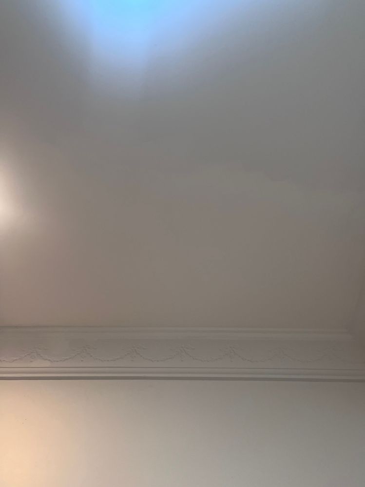

Thanks for the tips @MitchellMc - followed those steps and here's the result. Couldn't quite match the paint so might have to do the whole ceiling at some point but at least crack is done. Cheers!
Re: Ceiling Crack
Nice work @tjc888! Awesome result and many thanks for sharing.
