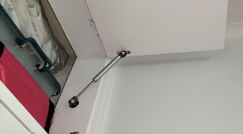

I used it on a top hung closet door, it was a real pain trying to get things in and out of it without a hinge or something to hold it open, I saw something similar in caravans so tried the same idea on the door.
Now it's on it could probably have done with a stronger one, the doors pretty heavy, but it stays open and does the full closing motion at the bottom, it just doesn't spring up so fast like they do on the caravan ones.
