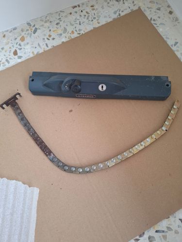

Thanks for your advise. Greatly appreciated.
As the winder was excessively corroded, it was completely stuck.
I did pry the housing open (sprocket, spring, etc fell out) but was ok as at that point I was able to move winder out and gain access to remove chain from the sash and replace it.
