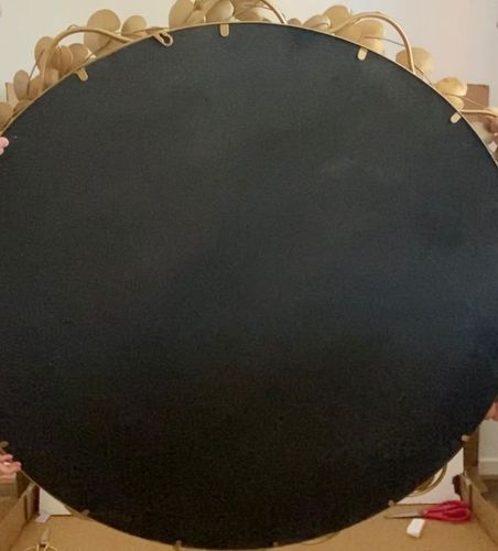

No, I bought the mirror itself and it was not supplied with anything to hang up. I’m looking to hang it on a plaster wall and attached a photo of the back of the mirror.

Many thanks for the image. I've highlighted the hanging fixture in it below. It appears slightly bent and should be perpendicular to the frame. You might be able to gently bend it back into place. As mentioned previously, it would be best if you could place a screw directly into a timber stud which will be located behind your plasterboard. If there is not one in the correct location and the mirror is fairly light, then you could use a GripIt 15mm Yellow Plasterboard Fixing - 4 Pack.
Once the screw is installed in the wall, the hanging fixture is placed onto the screw head, which holds the mirror in place.

The mirror is quite heavy and requires two people to lift it. So what kind of screw do I use and how do I use the Griplt 15 mm yellow plasterboard fixing?

It’s also welded in so I can’t bend it into place.

Something that requires two people to lift sounds like it should be fixed directly into the timber framework. The GripIt 15mm Yellow Plasterboard Fixing is capable of holding up to 40kg static weight. There are also some more heavy-duty versions, though their included screw head size gets larger and might not fit in the fixture on the mirror.
I'll include a video below which shows how the GripIt is installed. You'll need to install it and then screw in your screw halfway. Your mirror is then hung on the screw.

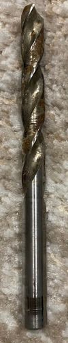

If I was to use the gripit, what kind of drill bit would I need? Would it have to be a 15mm drill bit? Also, is it possible if I could use the drill bit (that I have attached) to drill into the plaster?
Also if I was able to find a wooden stud, what kind of screw would you reccommend to use? And would I need to drill a hole before hammering the screw into place?
