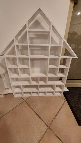

I would like to hang this printer's tray in my brick wall but not sure how to go about doing it? My guess would be 3 screws (one at the top, one on each side) which it can rest on, but not sure which screw size and wall plugs to use as part of the screw will need to stick out? Also what size masonry bit to use on my drill? I have brick walls and the printer's tray is quite large and heavy and will have ornaments on it.

I propose using the STAHL Masonry Kit 7mm Drill With 50mm Green Wall Plugs. This is an excellent kit as it comes with the masonry drill bit with it. For a more secure fit, I suggest using Hafele 23 x 23mm Angle Bracket - 20 Pack and screwing the printer's tray with Zenith 4G x 12mm Zinc Plated Hinge-Long Thread Countersunk Head Timber Screws. Please double check the length to make sure that it does not go past the thickness of the panels of the shelf. I recommend two brackets at the top sides and two at the bottom sides.
