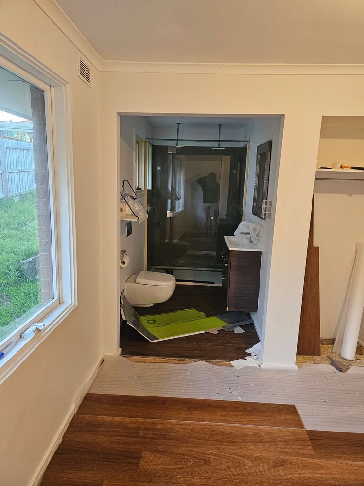

Just looking for recommendations on how to go about installing a door in a bedroom that leads to bathroom. The space is a bit larger than normal (2070mm x 1030mm) so a regular door wouldn't cover all the space. Just wondering what my options are here.
Does Bunnings Door installation cover this type of service? I'm also not opposed to DIY as long as it's not too difficult.

Welcome to the Bunnings Workshop community @DerrickJ. It's splendid to have you join us, and many thanks for your question about installing doors.
Given your opening size (2070 mm x 1030 mm), a standard single door won’t cover the space, so you’ll need to consider alternatives like bifold doors, double doors, or a sliding barn door system. Bifold doors fold neatly to one side and can cover the full width of the opening, making them a practical and relatively DIY-friendly option. As it is a fairly large size for the opening, you will have to either order a custom door, such as the BF29 Humecraft Bi-Fold Door, or reduce the size of the opening considerably to accommodate an off-the-shelf size. If you're looking for a low-cost, lightweight door, you can also check out the Pillar 82 x 203cm White Monaco PVC Concertina Door, but once again, you will need to alter the framing to suit the size of the door.
Installing two standard doors that swing from either side to meet in the middle is another straightforward solution and works well if you prefer a traditional look. A sliding barn door can also be an elegant and versatile option, as it can slide to one side when not in use and potentially cover the recessed area to the right, adding both function and a visual feature. Cavity sliders are likely not suitable, since you don’t have a cavity wall on either side of the opening.
Bunnings Door Installation typically handles standard internal door installs, so for specialised solutions like bifold, double, or barn doors, it’s best to check with your local store or consider tackling the project yourself if you’re comfortable with the hardware and mounting requirements. Ultimately, your choice will come down to the look you want and how you want the door to function day-to-day.

Thanks for the reply Mitchell.
I'm curious how big of a job it would be to reduce the size of the opening to accommodate for an off the shelf size door. Looking for a more traditional look. I hear a barn door option is pretty cost effective but concerned with the privacy issues of not being able to lock a door, along with noise and smell concerns. If I looked at installing two standard doors that meet in the middle, would they be able to close?
Also curious about the pricing for the options you've laid out if able.

You're very welcome, @DerrickJ.
Reducing the size of the opening to fit a standard door isn’t a major job, but it does depend on your skill level and the wall construction. Essentially, it involves adding framing timber, usually 90 x 45mm pine, to narrow the width of the opening, then re-sheeting and finishing the area with plasterboard and trim. For a carpenter, it’s typically a half-day job, but it’s also quite achievable as a D.I.Y. project if you’re confident with measuring, cutting, and fixing framing timber. You’re right to consider privacy, noise, and odour with a barn door between a bedroom and bathroom. While they’re a cost-effective and space-saving option, barn doors don’t seal tightly and usually can’t be locked, so they’re not ideal for spaces where privacy is essential. Here's a helpful guide: How to build a stud wall, How to install a door jamb and How to hang a door.
If you prefer a traditional look, installing two smaller hinged doors that meet in the middle can work well. They can close properly by using a rebate or a door stop strip in the centre so one door overlaps slightly to seal the gap, and a flush bolt can hold one side closed while the other operates normally. In terms of pricing, reducing the opening might cost around $50–$100 in timber, $100-$150 in plasterboard and accessories, a standard internal door and jamb kit usually ranges between $150–$250, and barn door kits are roughly $200–$400, including hardware.
If you’re comfortable taking on some light framing work, going with a traditional single or double-hinged door will likely give you the best balance of privacy, appearance, and practicality if you're not prepared to re-size the opening.
Hi @DerrickJ
If you are going to resize the opening, you will need to consider which way the door will open (into the bathroom or into the bedroom) as you need to have clearance for the door. Opening into the bathroom, the toilet or the vanity may get in the way. Opening into the bedroom, it may fall foul of the bed or other furniture which is possibly why it is the way it is.
