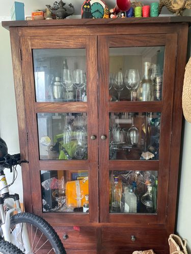

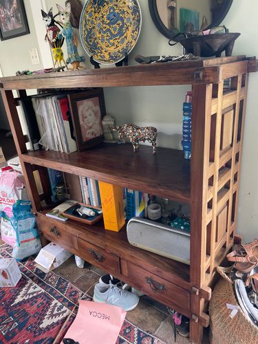

Hi. I have two beautiful heavy teak pieces I purchased for an older home. Moved to a coastal Bach house and they are way too ‘heavy’ for the space. After 9 years I’d like to grey the wood without destroying the grain.
any ideas please?
I used steel wool and detergent on a patch but it took ages for one little spot.
thanks for ideas.

Would you be able to post some inspiration pictures so our members can get a better idea of what you'd like to achieve? Depending on the degree of weathering you'd like to see, there are likely several methods which could be considered.
You might like to take a look at Rust-Oleum 887ml Chalked Ultra Matt Paint or Rust-Oleum 946ml Milk Paint Finish or Dulux 1L Design Chalk Effect Paint tinted to a light grey colour. All of these can be applied as a semi-translucent coating which, if done in light coats, won't block the grain of the timber.
There are a bunch of home remedies to create an iron oxide solution that greys timber. Most of these involve soaking steel wool in vinegar overnight and then applying the solution to the timber. It might be worth giving one of them a go in an inconspicuous location.

Thank you so much. I was thinking about that option but was worried it would look thick and heavy. Light coats it is.  Thank you.
