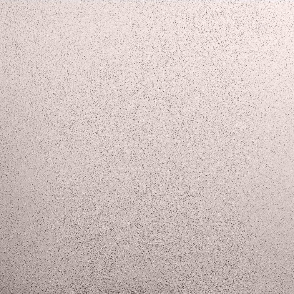

The render on my house exterior has a spiky finish which makes cleaning difficult and traps dirt (first photo).
I'd like to re-paint the walls myself with a roller but don't want the same finish and would prefer a flat surface so it's easier to clean. Is this the correct roller to use?

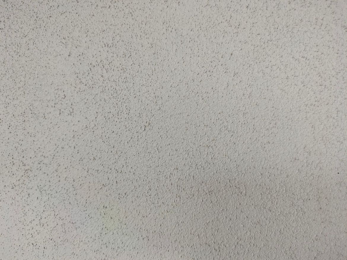

I think my existing might be rockcote with a sandy texture (second photo) which I don't want. Can I just paint over without sanding? There are a few very small gaps where there is no render so I'd like to repair these first.

Unfortunately, painting over a rough, textured render will not remove the texture. Multiple coats of paint may slightly soften the appearance, but they won’t give you a truly smooth surface. If you want a flat, easy-to-clean finish, the texture would need to be removed first, usually by sanding back the render or applying a skim coat of smooth render over the existing surface. You'd need to speak with a professional renderer about whether they can apply a new smooth render over the painted surface, though this can be tricky because paint can affect adhesion.
For your other questions, a standard Dulux Weathershield acrylic low sheen paint is fine for exterior walls, and it doesn’t require a primer if the surface is in good condition and the existing paint is sound. For small gaps where there is no render, it’s best to repair these before painting so the finish is consistent. Here's a helpful guide: How to repair a rendered wall.
