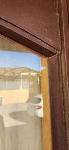

Hello @anaedeia
Welcome to the Bunnings Workshop community. It's sensational to have you join us, and thanks for sharing your question about re-sealing your glass window.
Would it be possible for you to post a picture of your window frame from the outside? We will then able to determine if your window is using Selleys 450g Linseed Oil Special Putty. It's a bit difficult to tell from the pictures you currently have. Once, we've confirmed that it is old linseed putty, you just need to use a metal scraper to scrape and remove the old linseed putty.

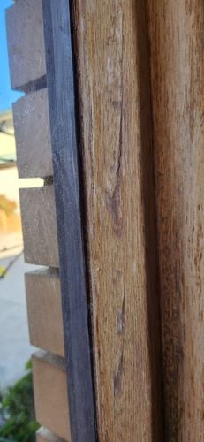

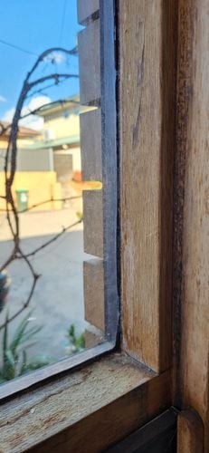

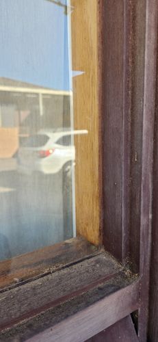

Hey Eric,
Thank you so much for the quick response! It feels a bit like a celebrity writing back to me after spending so much time on these forums.
To my untrained eye, it doesn't look like there is any putty or sealant on the outside. Maybe it has worn away over time? The unit was built in the 70s and very little was done to maintain/upgrade it.
Thanks Ahayrususa 😊
Hello @anaedeia
Thank you very much for the compliment! It appears that your window is held in place with timber strips. Before taking the timber strips off, please note that working with glass is dangerous as an accidental hit with a tool or when too much force is applied to its surface can make it break and shatter causing injury. Please make sure to wear personal protection such as gloves, goggles and a mask when working on your windows.
In order to get the strips to lift off, I suggest using a Craftright 3 Piece Wood Chisel Set along with a hammer. Your goal is to get the timber strips to lift up and off the window frame but not destroy it as you'll need to reuse it later on. I suggest placing your chisel just between the window frame and the strip itself.
