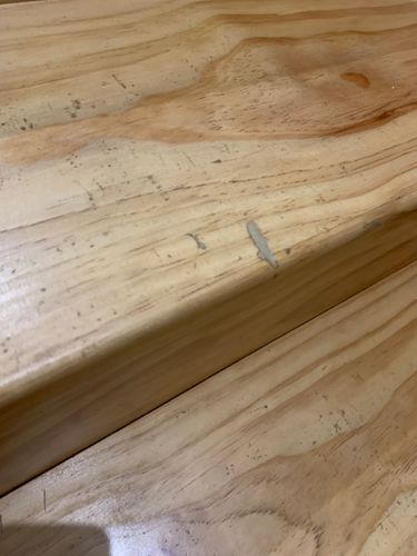

Hi all! My timber stairs are scratched up from wear and tear, as well as some chips etc. wanting to sand them back and recoat them.
they are not stained, just like clear coat..?
Best way to sand them?
what do I use to recoat them?
I heard something about needing non slip paint?
thanks!

Thanks for the photo @damien-22.
Let me tag @EricL so he is alerted to your reply. I'm sure he will get back to you ASAP.
Re: How to recoat timber stairs?
Hello @damien-22
Thank you very much for posting those pictures of your stairs. Looking at its current condition, I think it's time for a new coat of sealer. To make sanding a lot quicker, I suggest investing in an electric sander. You can get wired or cordless depending on what tools you currently have. If for example, you have a Ryobi One + drill system then all you need to do is to purchase a sander that is compatible with the One + system and the battery on your drill will work on your sander. The drawback is that you'll need at least 2 batteries to continue working without waiting for the battery to charge.
Of course, a cabled sander will give you uninterrupted service, but you'll need to invest in a long extension cord. As I mentioned in my last post you need to identify what type of sealer is on your steps whether it's water-based or oil-based. Once you know which one you have you can then start to look at the finishes available gloss, low sheen, satin and matt finish.  My number one tip for choosing your polyurethane sealer is to make sure that it is for floor use, not furniture use.
Unfortunately, most of the non-slip coating is intended for outside industrial use. I suggest using a satin finish instead of a high gloss finish to provide a better grip on the steps.
