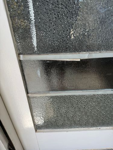

We purchased our 1950 built house in the Adelaide Hills in mid 2024. We love the front door but it is in desperate need of repair. I want to strip it back and somehow repair the strips across the glass panels. Some of the ‘putty’ behind the strips has fallen out. Hoping someone can offer advice. We don’t have the option of sending the door to an offsite refurbished (min 4-6 weeks) or buying a door for the interim. Hoping I can find a way to do everything at home, even if it takes a while and I need to work in stages.

It is difficult to tell what kind of filler they used back in the 50's, but I would suggest using Selleys 430g White No More Gaps Exterior Gap Filler as a possible replacement. In regards to the actual glass separator/holder, I propose having it remade in plastic by engaging the services of a 3D replication shop. You can therefore get the exact fitting with the same dimensions and it will save you from having to modify the door.
In regards to the painting of the door, the general steps would be the same which is to sand it down, clean, then prime and paint. It's good to hear that you've had the door paint tested, this is an excellent safety step to take before you begin your project.
Please remember to wear personal protection such as gloves, goggles and a mask.
