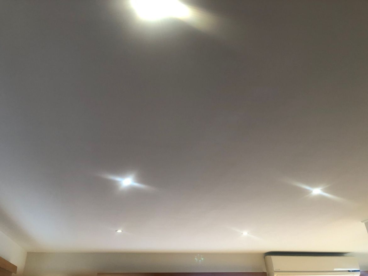

I only used the Rapid filler on a very small strip, and on a few other sections I used the Uni Pro Multi Purpose filler. See images.
The surface of the ceiling was nice and smooth before I applied the paint, sanded with 220 grit and also cleaned with a damp microfibre pad.
The roughness you see I think is because the paint was very gluggy when I applied it and very sticky as I see it.

What kind of roller did you use? Typically, we'd use one with a 12mm nap on a ceiling. I'm asking because I've never really seen roughness like this introduced due to temperatures.
It sounds like you're on the right track and a sanding is required to knock down the peaks on this roughness.
I'd question why the paint is gluggy or sticky. It should be thicker than water but should flow quite easily. Was it an older can that you've had sitting around, and whether it is new or old, did you give it a mix before starting? If it's a new can, I'd be inclined to take it back to the store of purchase and show them the images. At a minimum, they can shake the can for you to ensure it's mixed correctly, or they might have some other ideas as to how this roughness has been introduced.

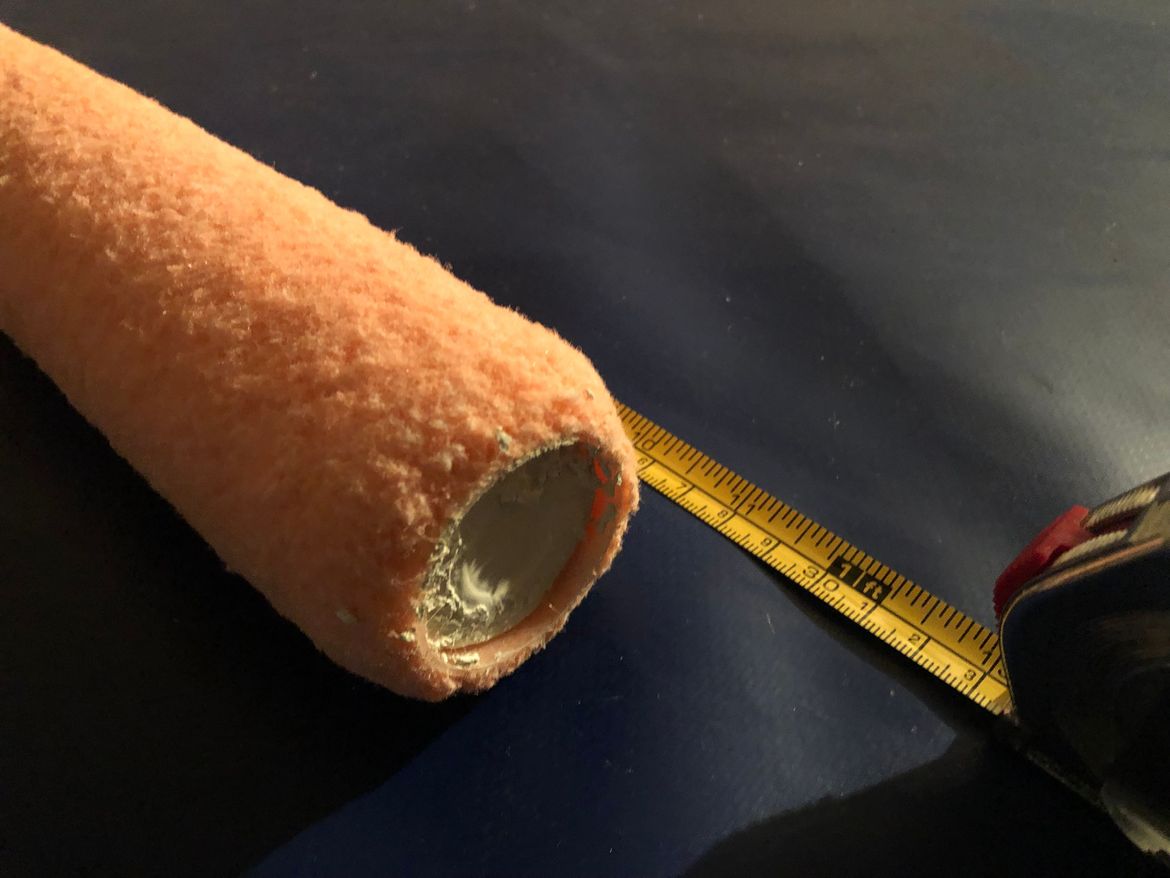

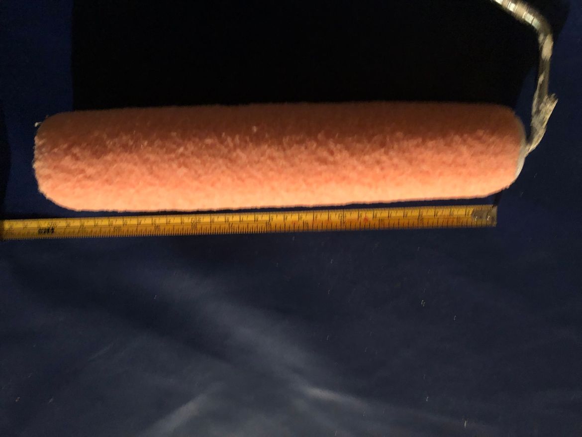

Roller was brand new from bunnings and intentionally IMG_2854[1].JPGIMG_2855[1].JPGwent for an extra wide roller - 30 cm.

ok thanks - does that roller look ok?
Re: Advice in several interior plaster crack types to repair in home
That roller appears fine, @johnk.

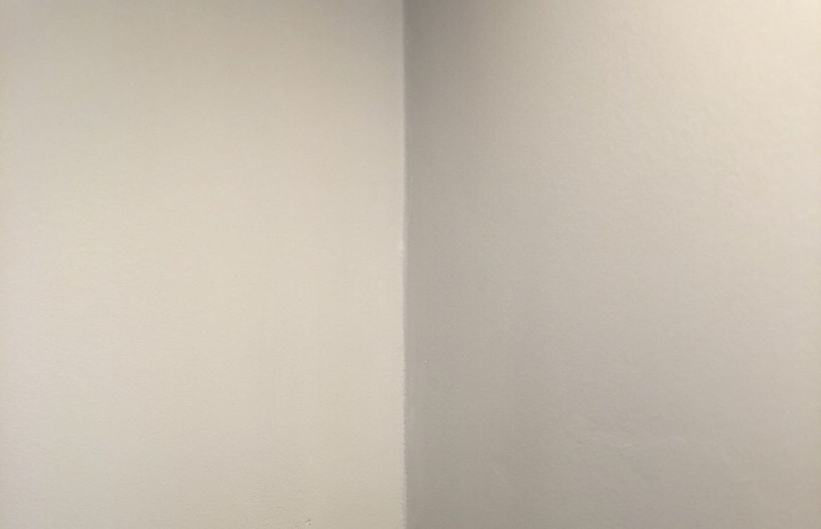

For the corner cracks, I used a mesh and then multiple coats of UNi-PRO 500g Multi Purpose Interior Filler. I then sanded and shaped this again and again over several days. If you are doing these type of repairs DO NOT use products like Selleys 180g Spakfilla Rapid Gap Filler. Products like this simply cannot be shaped and sanded! I am not sure I would recommend this product for anything other than maybe a small tiny hole needing to be repaied in a hurry!

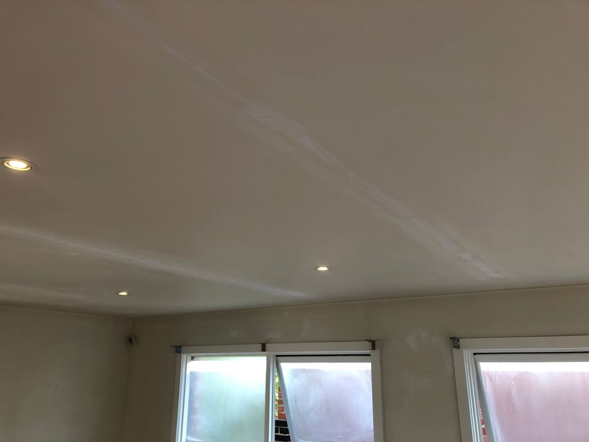

For the ceiling cracks, I did not use any mesh. I simply sanded flat the ceiling area, and filled in with by finger and a small spatula the cracks - sure the cracks might re-appear in the fure, but they took 25 years to be created so I'll simply fill them in again in 25 years!

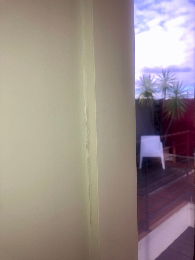

I took the opportunity also to fill gaps between all the windows and walls with a flexible tube of filler and then paint over this. This has created a nice finish and there is less creaking sounds coming from the windows due to temeprature changes. Did a similar thing with some of the timber trims from the kitchen that hit the wall. Sealed these multiple times over several days to get a nice finish. There were 18 of them!
