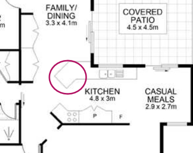

We do have a couple of boxes of the old flooring left (apologies, should have mentioned that in my original post) - my concern is more around the way the flooring clicks together and if the missing pieces can be 'patched up' without taking out the existing flooring. I've attached a phot of the layout to give you a better understanding of what I'm talking about. The circled end is the concern area - once we replace it with a different shape bench, there will be a gap in the flooring and wondering what the process is (if any) to fix a gap in the click lock flooring?
Thank you!
It’s great that you still have some of the original flooring on hand, @mariabalint, as that gives you the best chance of achieving a seamless look.
The challenge with click-lock systems is that they are designed to be laid in sequence, so patching in new boards mid-run can be tricky. This is typically a job best left to a professional installer, but to give you an idea of the process, you would usually cut back the existing boards so you can re-establish the staggered pattern. In most cases, the click mechanism on the replacement boards needs to be trimmed off, as it prevents the boards from being dropped into place. Once cut to size, the boards are then glued down instead of locked together, which is similar to the technique used when repairing tongue-and-groove flooring mid-room.
Depending on the space, you may find you can slide the new boards in without trimming, but if not, gluing is the usual method. This way, you can fill the gap without having to pull up the rest of the floor.
