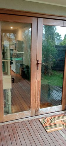

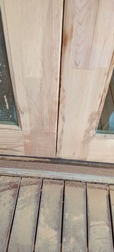

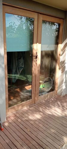

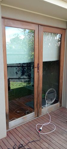

@JacobZ @MitchellMc I decided to finish the doors before coating with a 120 grit finish. Havn't started on that yet due to heavy rain but got the first set of doors done yesterday for the finish to be done when the rain clears up.
Here's some before and after photos
Hello @Innov8tive
Thank you very much for the update! Those doors are looking good and will probably look fantastic once you've applied the sealer to it.
Thanks! The detail is time consuming and arduous and buffing out the deep dogs bites and clawing from previous tenants us hard work but I really look forward to lovely doors on the outside. Can't wait to see how they turn out.

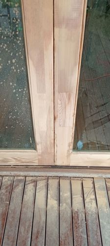

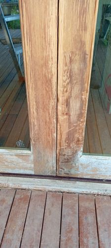

Other than that the doors are coming up well. The dog bitten door was the hardest and I've got it looking the best that it's going to get I think. I've included before and after photos of that below.
Great work @Innov8tive. If the dust catcher keeps coming off, I'd take it back to the store of purchase so our team can check it out for you and swap the sander over if it's faulty.
