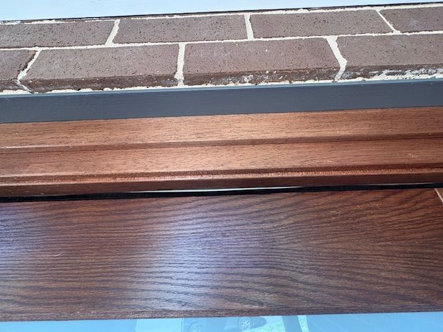

We’ve just moved into a newly built house and noticed a visible gap at the front entry door.
47fab7f2a6692601211581e1da17e29c.JPGIs there anything we can do to fix this?

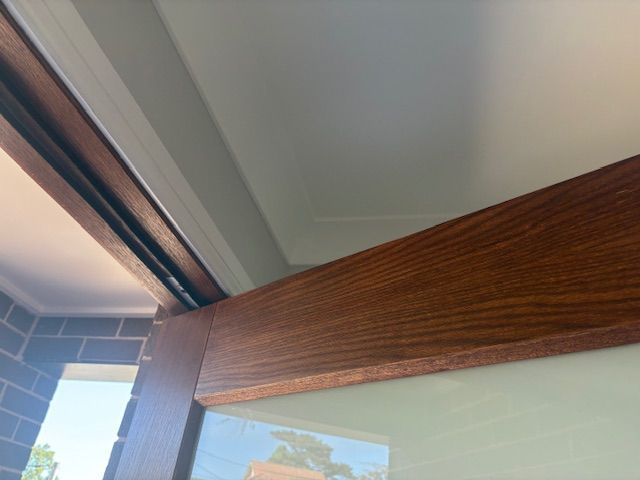

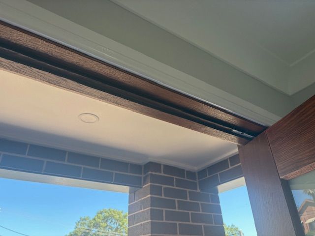

Re: How to seal the gap at the front entry door
Hi, @JacobZ, there should be a door stop there. Do those photos help? IMG_7156.jpgIMG_7157.jpgIMG_7158.jpg
