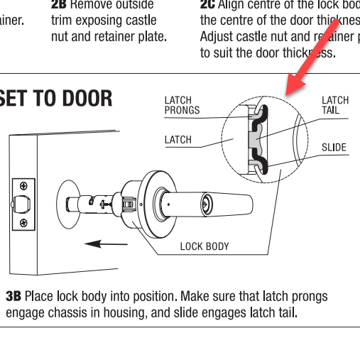

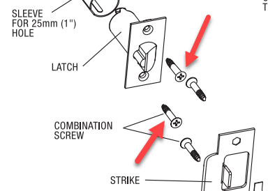

Hi @minklet,
Having a look at the videos, it seems like the latch is moving.
I'd try tightening the screws that attach the latch to the face of the door.
This may help to stop some of that movement of the latch.
If this doesn't fix the issue, could you remove the latch and assemble the lock outside of the door?
I suspect the issue probably lies with where the latch connects to the lock body.
Some slack or a slightly bent piece could allow for this movement.
Let me know what you find.

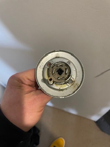

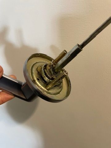

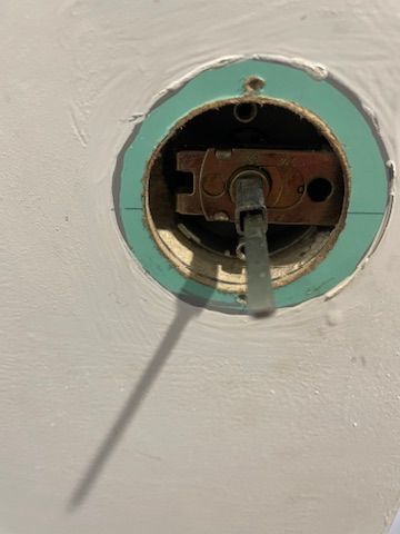

The latch is 100% screwed into the door as tightly as possible. I've taken it apart and put it together outside of the door, and it's no different
The tube that the handle attaches to, both of those (inside and outside) are wobbly

Hi @minklet,
Looking through the installation instructions, I can't really see anything else that can be adjusted.
The castle nut that Alan mentioned can be adjusted, but if it is wobbly outside of the door, then I doubt it is really going to do anything.
Unfortunately, the internal components may have just worn down over time, which would mean your best option is to replace the door handle.
Luckily, it should just be a simple case of swapping the door handle out for the new one as all the holes are in place ready to go.
Let me know if there is anything else I can do to assist.
