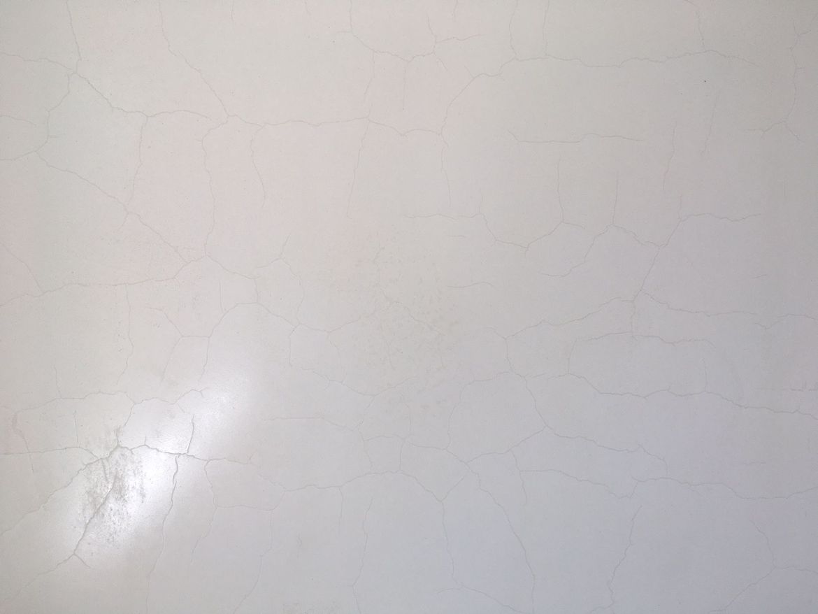

Hi Everyone
My new build house white set plaster wall showing cracks everywhere after using dulux oil base sealer( my builder recommend). Do anyone have the same issue ? is this normal for new plaster wall or it's a quality issue of my plaster wall ? looking for help.I am very frustrated after seeing that. I am  appreciate for everyone's reply.Many ThanksIMG_0400.JPGIMG_0407.JPGIMG_0399.JPG

If your plaster coat is brand new, one of the main reasons it would crack is because of heat. If the plaster was exposed to extreme heat or the heater inside the house was turned on for too long while the plaster was still fresh, this will cause shrinkage. When the plaster shrinks it starts to compress and the cracks start to appear.
Using the Dulux oil-based sealer is suppose to hide the cracks, but if they are too big and deep the paint primer will not be able to cover them. Because the plaster is new, it is still under warranty, I suggest calling your plasterer and having them repair the cracks.

i found this site on line that might help with your cracking situation, I agree with @EricL , contact your builder, it should be under warranty.

Thanks JoeAzza. it's very helpful. I will contact my builder immediately.
