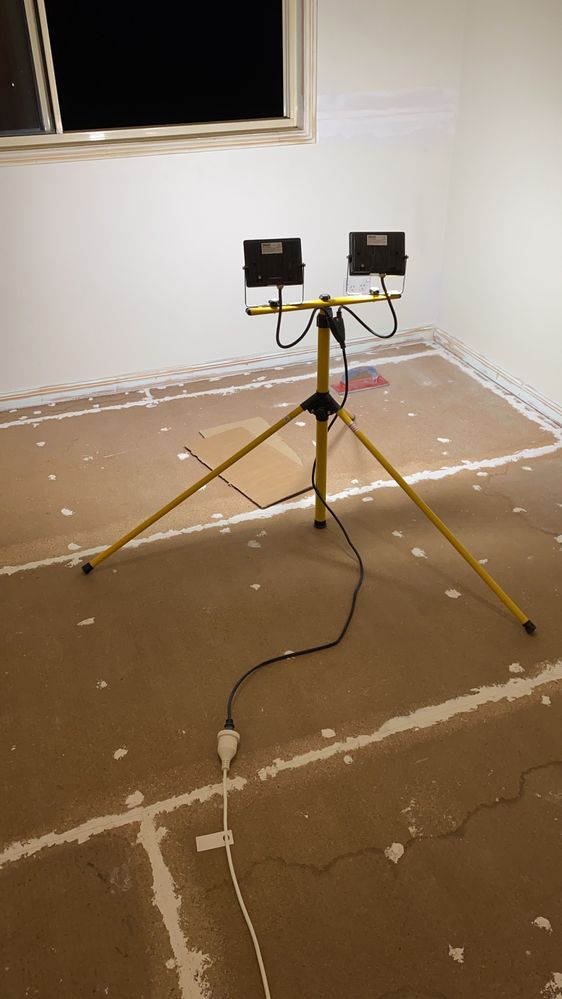

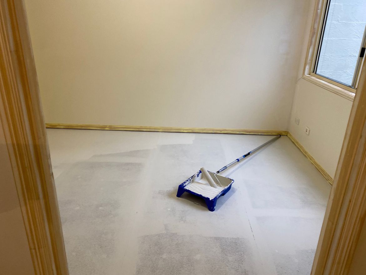

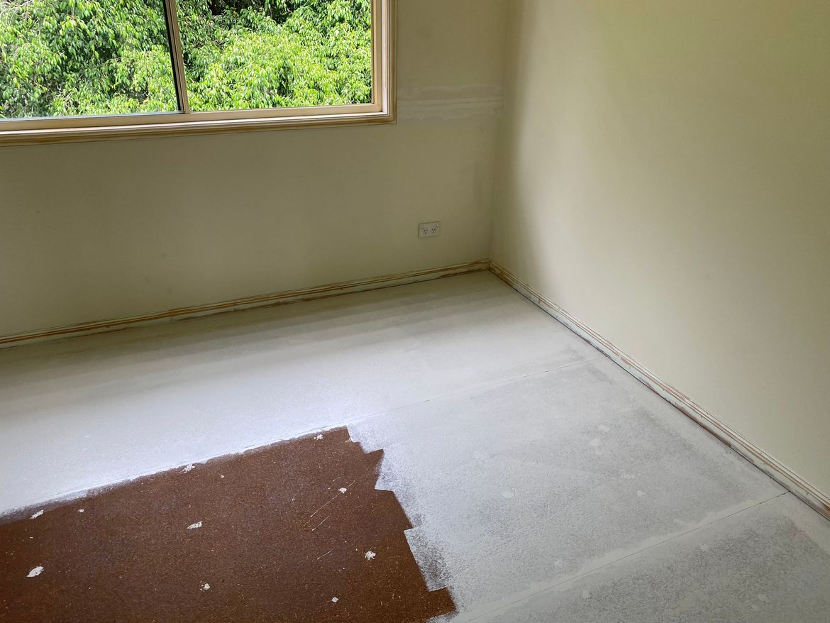

I looked at my flooring options and until I have the budget to match what I would really want, I decided to paint the sub flooring which turned out to be OSB / particle / chip flooring (I was hoping for plywood).
I have Feast Watson floor paint and I will get the Proofseal today.

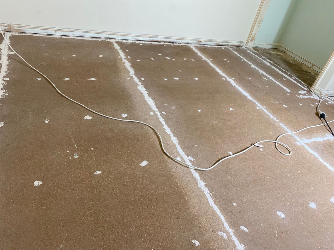

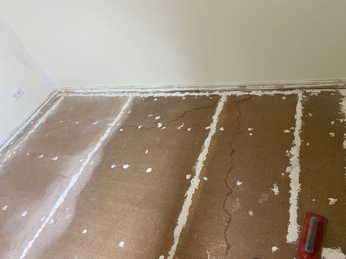

My BIG Q is now what should I do with the thin hairline cracks you can see between the flooring sheets? I used Timbermate Wood Filler to fill any cracks and spaces between the flooring sheets. After 2 months the floor has shifted hence you can see very fine lines.
What is the best product to use to seal this since I believe if I use the Proofseal followed by floor paint - I will still see the lines or near future if the flooring shifts, cracks are back?
Someone suggested Fiberglass waterproof filler?
Many thanks in advance
Hi @Nanne
I suggest using Nordsjo Professional Flexible Wood Filler 500ml. It is a flexible wood sealer and can be painted over, this should work well with your timber flooring. Some stores have this as a special order product, I suggest giving your local store a call and seeing if it is in stock. If it isn't, I suggest placing an order with the special orders desk.

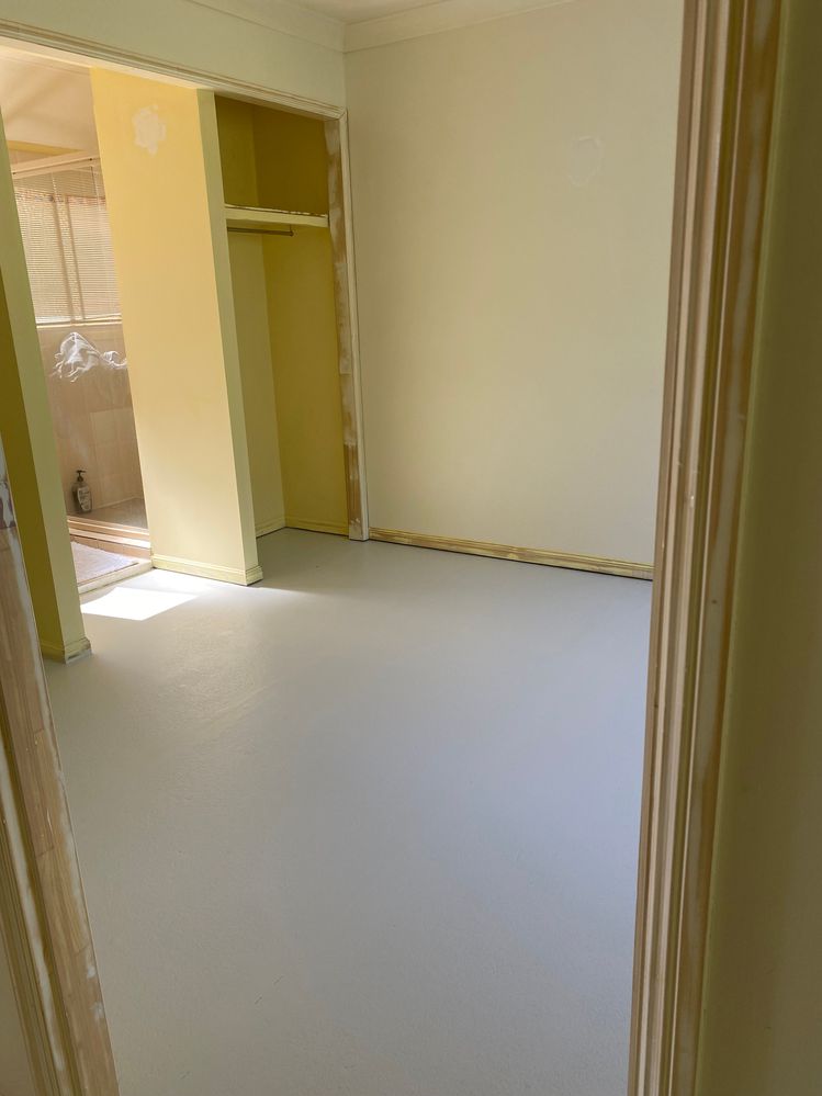

Is there a floor coating that would make the surface hard? I used Feast and Watson Proofseal and Floor paint (see pics). I am happy with the temporary solution, since it is particle / chippy flooring anything too heave that accidentally drops on to the floor will crack the surface.
Hello @Nanne
Thank you very much for posting that update, your floor looks fantastic. The paint that @Mitchell recommended is actually the ideal product for your floor. To get extra strength for the surface, I suggest putting on an extra coat on top. Because of the nature of the material of your flooring, it will tend to chip. I suggest looking at carpet runners to cover the areas that will get a lot of traffic. This will also serve as a buffer for anything that might drop on the floor.
