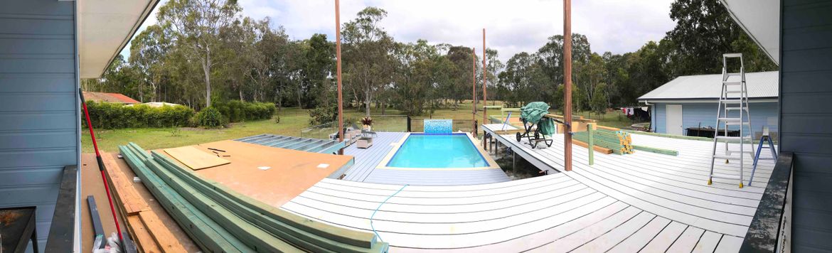

Well after months of delays due to everything from weather to design changes to me breaking my leg on-site… (yes, still in plaster…) we finally have our floor framing in!!!
This is the biggest stage of our owner-builder reno & extension project.
Most of this will be deck & undercover outdoor entertaining space but it will also include a purpose-built home-office (far end on the right) & new master bedroom (left above pool).
We used steel for the floor framing for ease of build – cost is slightly higher but you gain on speed of assembly and virtually zero wastage. It's also a lot stronger so avoids the traditional bearer & joist multi-layered arrangement although I did have them add sub-bearers in a couple of spots.
Can’t recommend SteelMax highly enough. You basically send them the plans & then you get everything on the back of a truck pre-cut, all you have to do is match the bits up & put them together like a giant Meccano project. They can do everything from decks to entire house floor frames.
I'll keep you updated as we progress!

A huge moment was getting the stringers in for the main stairs from the deck to the pool area & then putting some temporary treads on them.
It’s the first time we’ve had direct access from the house to the pool!
And… it meant that I got all my measurements & set-out right as the off-the-shelf stringers were exactly the right size & fit !
Gotta’ love that ![]()

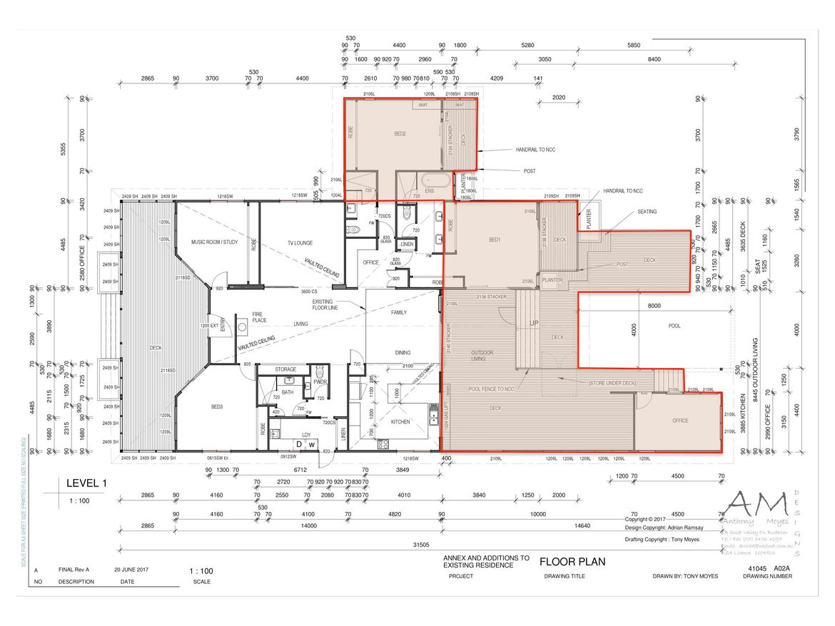

Hey @MartyH, just realised I never shared any plans with you! My Bad.

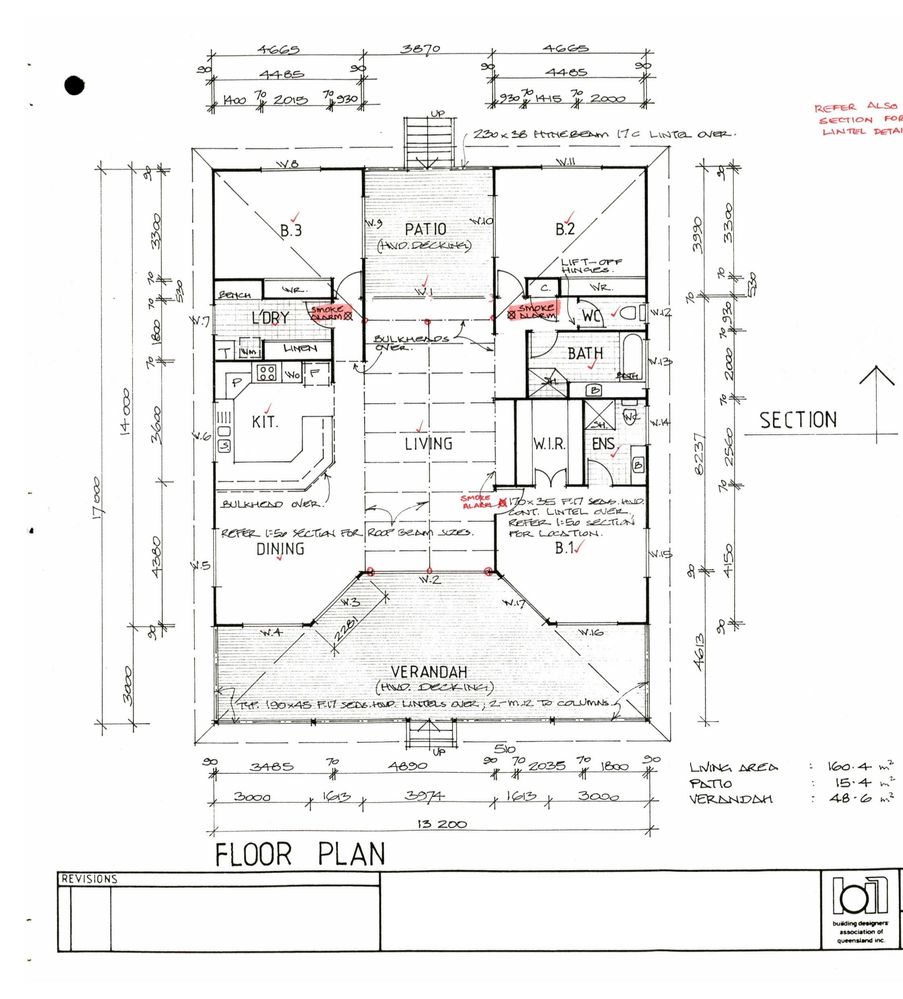

Ok... first one is a copy of the original plans from when the house was built as a holiday home in 1999.
Second one is the new plans with the new build section highlighted. You can compare the internals to see what we are renovating too. Ignore the window locations etc in the new section. The designer was being a bit crazy with window numbers and types.
Third one is the office layout I've arrived at. This doesn't include stuff like bookcases, just fixed items.
We have no idea how far we'll get with our plans. Well, we do... as far as we can before the money runs out... but we've planned it so that each section is an individual project meaning we won't have loads of stuff torn apart at the same time & if we have to stop for a while we can do so without living in a total disater area.
