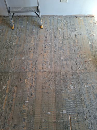

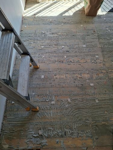

Hi everyone,
I’ve just finished pulling up the old tiles in my kitchen and now I’m left with a floor covered in stubborn tile adhesive. I need to get it back to a clean, even surface so I can lay a floating floor on top.
What’s the best way to remove the adhesive? Would you recommend using a specific tool (scraper, angle grinder, oscillating multi-tool, etc.) or is there a product/solvent that makes the job easier? I’m trying to figure out the most efficient method without damaging the subfloor.
Appreciate any tips or experiences you can share!
Thanks in advance.
Hello @StefanAUS
A quick way to remove the old adhesive is to either use an XU1 810W Corded Belt Sander or hire a For Hire: Orbital Floor Sander - 24hr. Since you are only after a level floor there is no need for a polished finish. Removing the old adhesive and achieving a flat level surface should be enough. I suggest starting at 120grit and finishing at 240grit.
