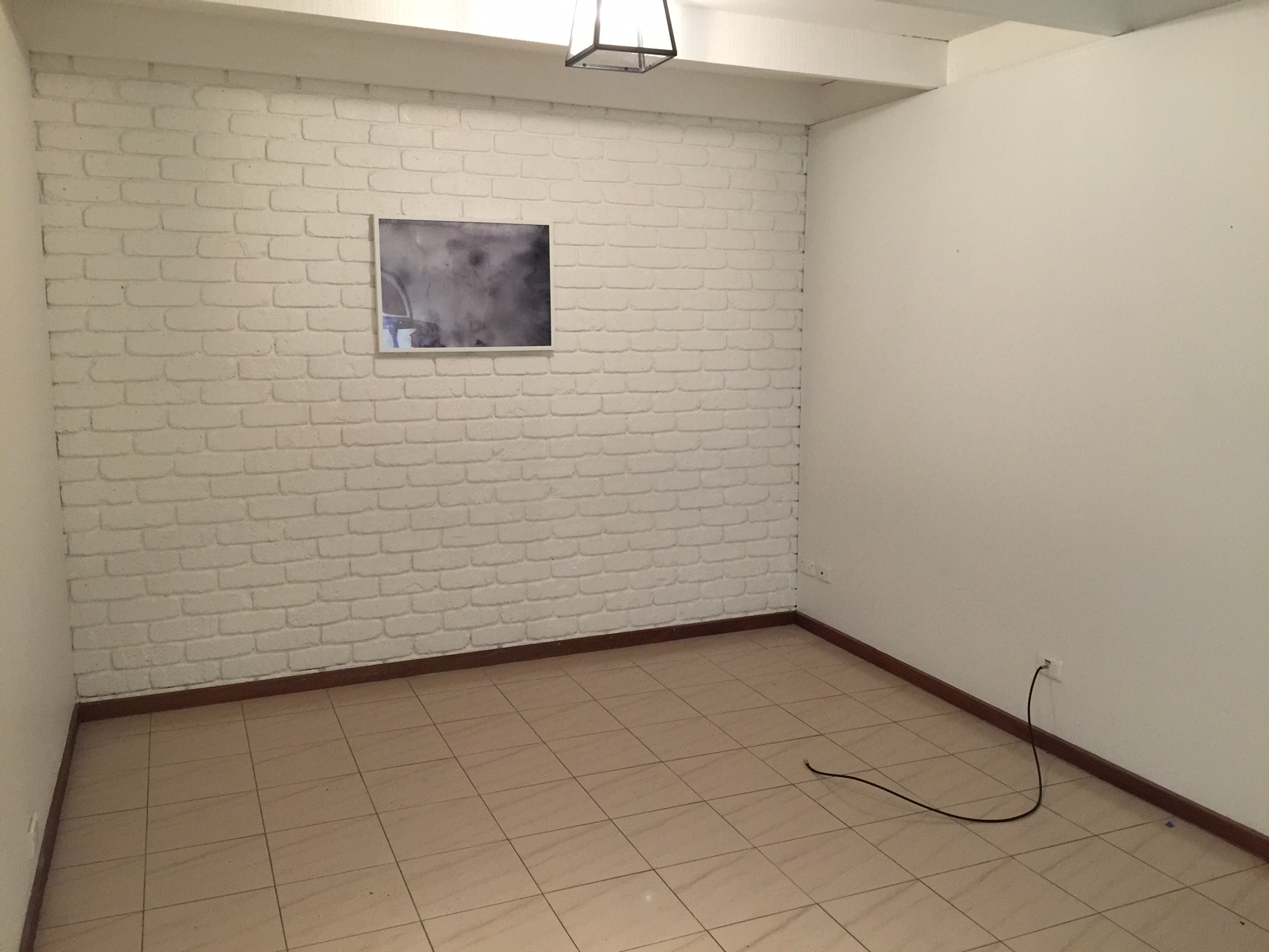

Hi.  I'm renovating a 60's home, and really enjoying the process.  I have painted, wallpapered, ripped out doors and shelving.  I love seeing what people have accomplished.  My next big project is to do something about the very old ceramic tiles. I'm wondering if I can cover them with vynal planks.  I know I would have to fill in all the grouting to make a smooth surface.  Any ideas on would it be a possibility or maybe have other options?

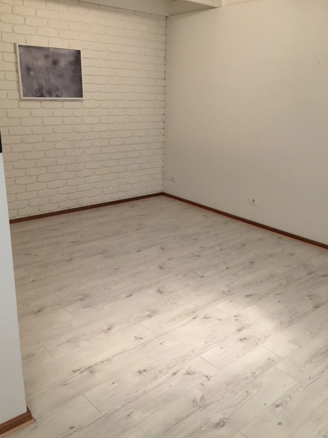

I've recently covered my ugly 70's tiles with Formica laminate floorboards. They don't require any underlay as it is already attached to the floorboards.
My builders covered around 40sqm in one day and the transformation is huge! We also had waterproof laminate flooarboards installed in our bathroom over the top of tiles and they also worked really well.

Budding Contributor
These are the old tiles I would like to cover with vynal planks.

Are you thinking of laying vinyl planks straight on the top of the tiles or are you planning on either removing them or using a floor leveller?

RodAndo. What is a floor leveler? Was planning to go over the top with vynal flooring.
RodAndo.  I am new to this site, and do not know how to reply directly to you.  I was hoping to lay flooring over the top of the tiles, once I had filled in the grout areas. But what is a floor leveler? Maybe I should bite the bullet and hire someone to remove the tiles and go from there.

Hi, Floor leveller is a concrete based compound that you can mix up and pour over an existing floor to make level.  It's not the easiest to use if you haven't done it before and can get very, very messy.  I wouldn't lay vinyl straight over the tiles as you will eventually get indents where the joins are.  Here is a video of what is required.  Floor leveller is available in various size bags depending on application/size of room.  You may want to get some advise from the vinyl supplier on your best options.  Ripping up tiles is no fun game either.
