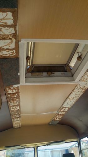

I've done pretty good job so far but having trouble with re roofing interior. Glue not working, every time it's hot it all falls down. Drill does not penetrate the metal on this bus. Should I be looking at a 15 gauge nail gun for this job? Or will this completely anialate the MDF I'm attaching? Any other ideas?

In pics through middle of roof I have used Flexi ply. Extreme strength liquid nails melts in heat n has caused warp and fall 😖
Pics of the problem area.

I would think epoxy glue would hold it but not the 5 minute stuff, neither cheap or easy :unhappy:
