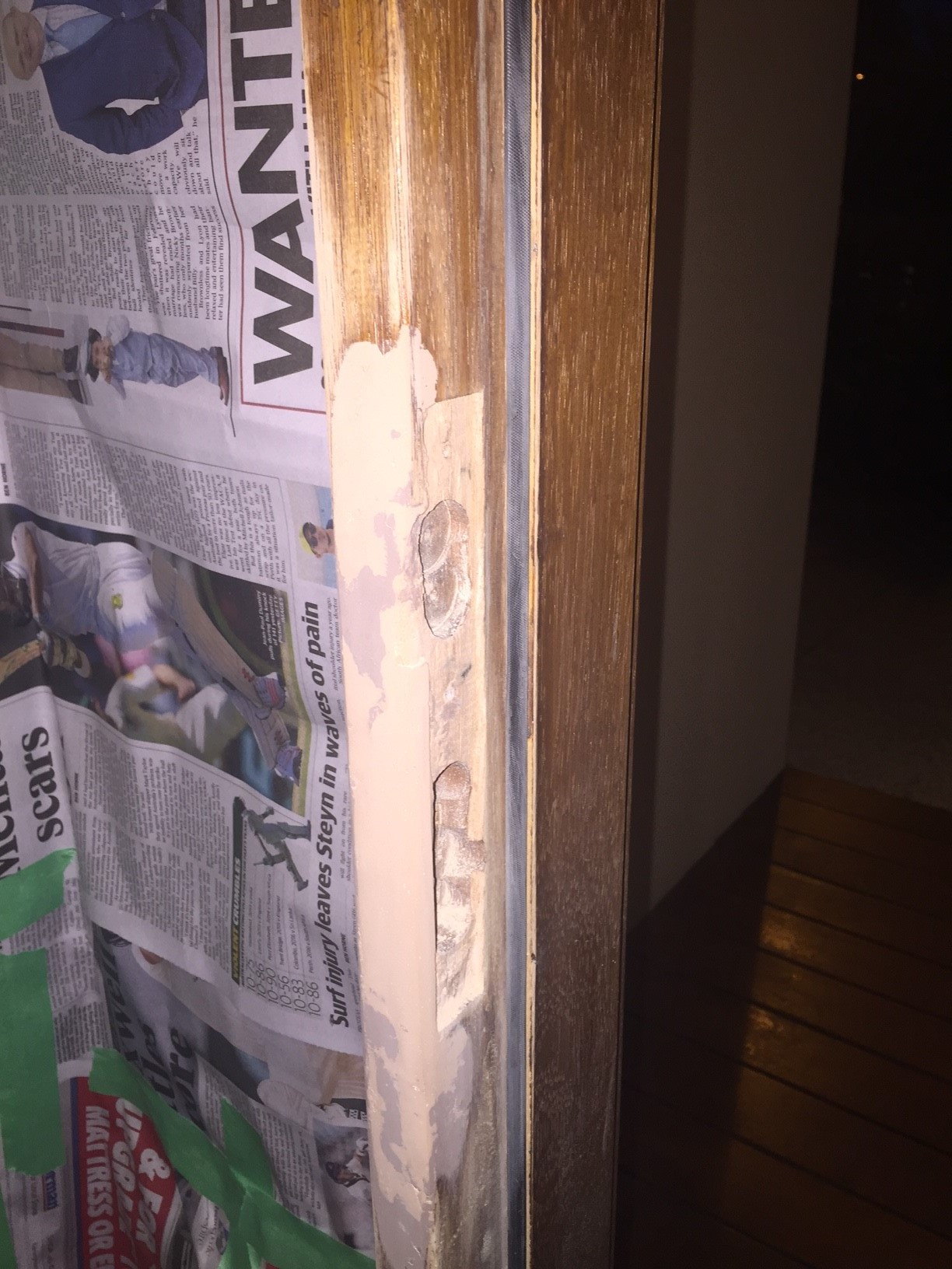

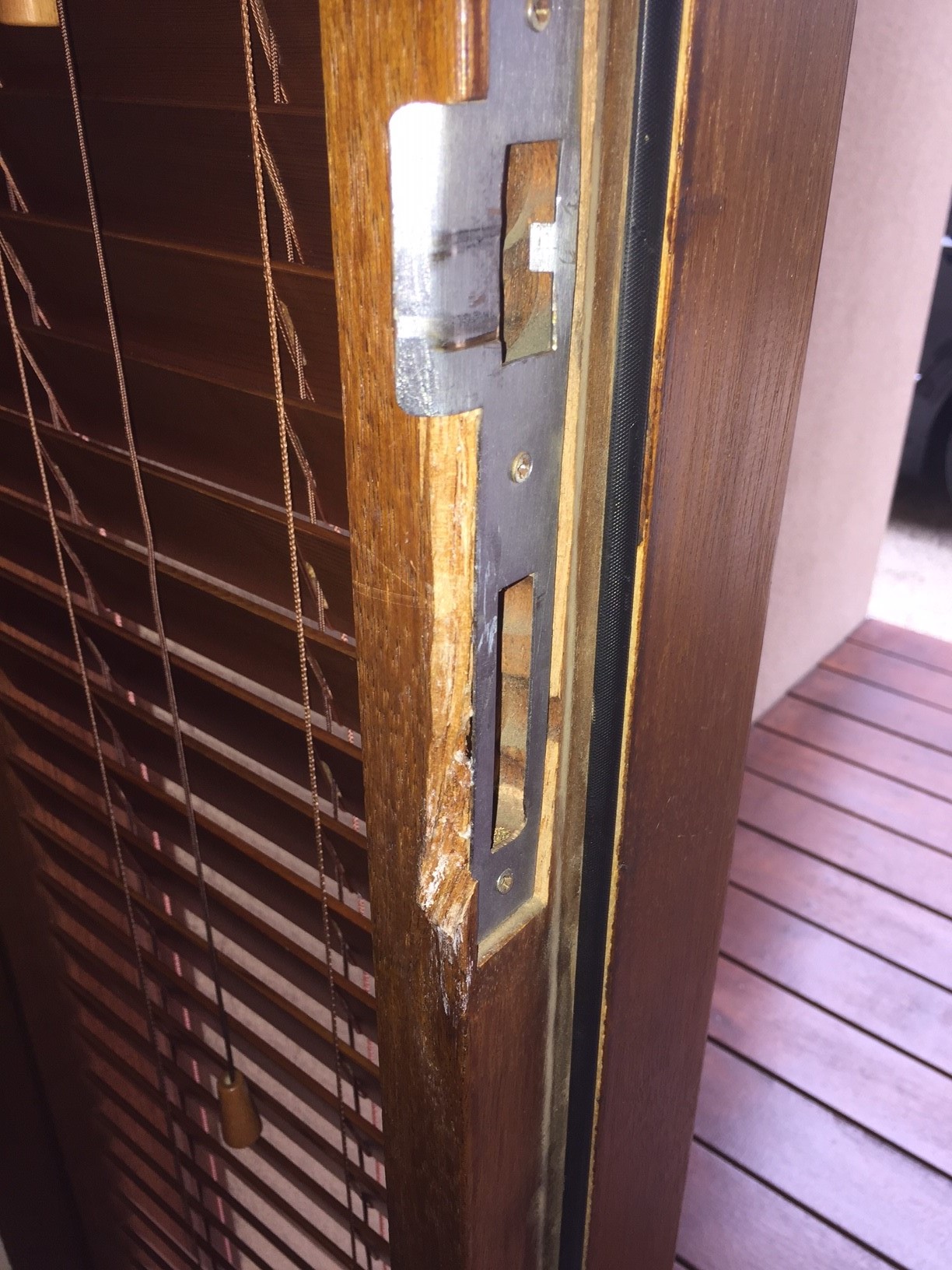

1. The original damage.

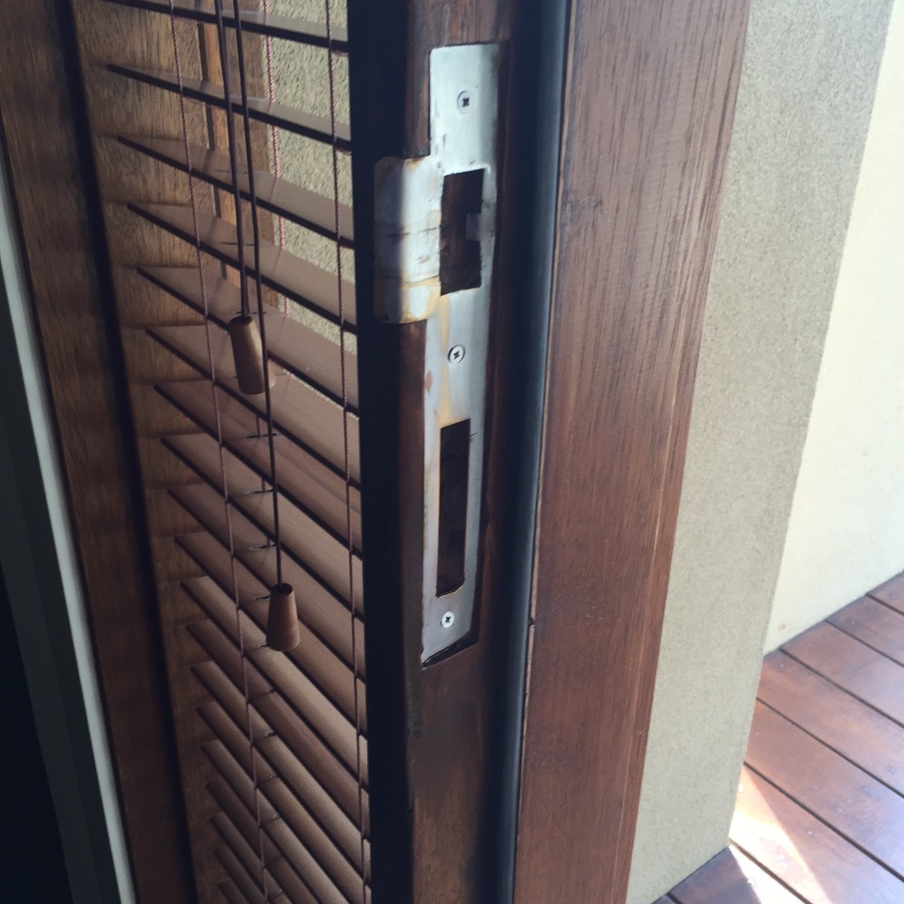

2. After multiple timbermate applications, sandings, and reapplications. At this stage - despite my reassurances - the good lady wife is threatening divorce!
3. After first coat of stain. At this stage I'm feeling there is some hope.
4. The final product. Not absolutely perfect, but acceptable, and saved us the significant cost of replacing entire door frame. Atleast you walk in and out of the front door without noticing it.
Well done @Ben, the final result looks fantastic, & your tips will be very handy for other Workshoppers, when they come to tackle a similar project.
