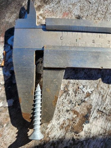

I use Alan's technique, but with failing eyesight I now most times use a vernier caliper - and subtract a few millimetres.
AlanM52
Amassing an Audience
Re: What drill size for a 25mm eye screw?
Yep... I started using this.
The missus still hasn't noticed it's missing from her sewing table 😊
