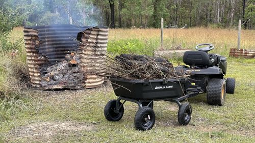

The cart is getting put to good use! We were finally able to clear 2 big piles of old vegetation today. For context, we don't have green bin collection, so any vegetation has to be composted, taken to the dump, or burned.
