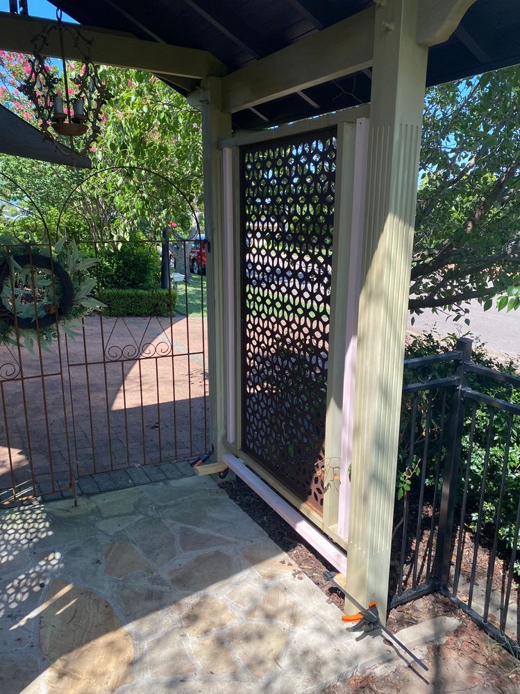

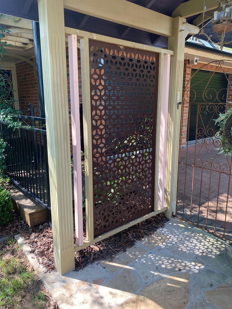

Hi All,
Just wanted to share a couple of progress photos. Whilst not perfect, Ive been really happy with the result. Cuts are getting much cleaner which makes joining a whole lot easier. Thanks again for the help to date.
Re: Would you buy a Mitre Saw or Circular Saw first?
Looking good @HunterProperty!
Thanks for the update.
:smile: and some more Cheering @HunterProperty :smile:
