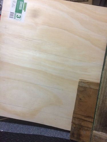

Hi guys! So I decided to DIY a shiplap look wall using plywood
but im needing some help as to how to engrave straight lines but about 1cm wide each
i tried with a box cutter but blade isent wide enough can anyone recommend something that would do the trick!? Thankyou!

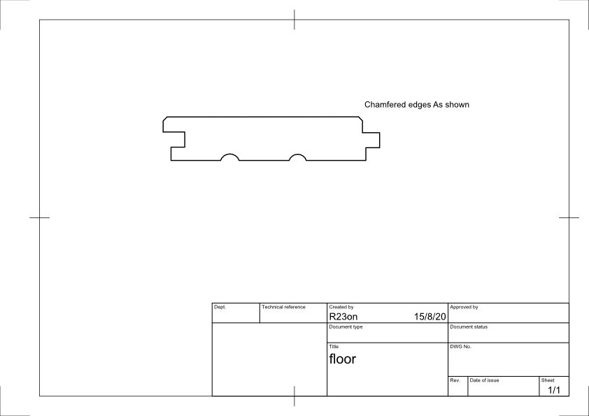

You can create the same affect by using pine flooring with the tongue and grove locking it all together or you could use Tas Oak. If you run a plan over the edge and giving it a nice chamfer between joints
Cheers
