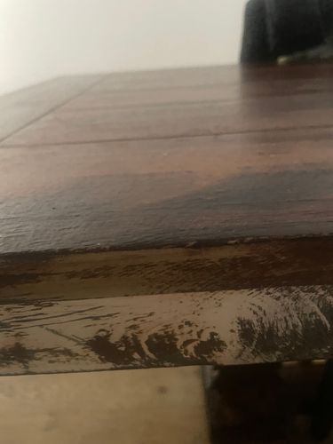

I’d like some advice on lightening this dining table. Ive tried sanding it on the side to see whats underneath. Please let me
know if sanding is the best option and the products i need to get this lightened. Thanks Vans

You're on the right track, sanding the surface back to wood is the proper way to repaint the surface of the table to your preferred colour. I suggest investing in an orbital sander as this will shorten your sanding time a great deal. As for the colour, I suggest visiting your local store and have look at the oil and stain varnish sample board. You'll get a good idea what the stains will look like when applied to timber.

i have an ozito detail sander, hope i can use it? I will get 40 grit sanding sheets and will give this a go.
I don't think i can sand the legs with a sander,  It’s ornate and detailed.
Would you recommend any other tools for ease? It would take me forever to sand the detailed legs manually,  Any thoughts? Appreciate it.

You're definitely on the right track by sanding the table to see what's underneath. Your Ozito detail sander will work well for the flat surfaces, especially if you start with a coarse 40-grit sanding sheet to remove the existing finish. Just be sure to work your way up to finer grits like 120 and 180 afterwards to smooth the surface before applying any new product.
For the ornate legs, it can be tricky since standard sanders won’t reach into all the nooks and curves. I’d recommend using sanding sponges, which are easier to mould around the shapes. If you have access to a rotary tool like a Dremel with sanding attachments, that can really help get into the finer details. Another option to make things easier is using a chemical paint stripper, like Polystrippa, which will break down the existing varnish. After it softens, you can scrub it off using steel wool or a scraper. Just make sure to wear gloves and work in a well-ventilated space if you go down that path.
