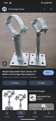

Hi
Do Bunnings sell something like this for a 50mm PVC pipe? Will be for a under ground drain for underneath a pergola that's fully uncover.  The only water the drain will get is us hosing the pergola floor
The pipe is 50mm diameter. And I want to hold it to some concrete that's about 100mm away
So the rod will hopefully be adjustable to

Hi @PatDIY_Dad,
Unfortunately, I'm not aware of a product that is the same as your image, but you can use Adjustable Stand Offs with 50mm Pipe Saddle Clips to attach the pipe to the wall.
Combined, they would hold a pipe pretty close to 100mm off the wall at full extension. If need be, you can use packers or washers to make up the difference.
Let me know what you think.
