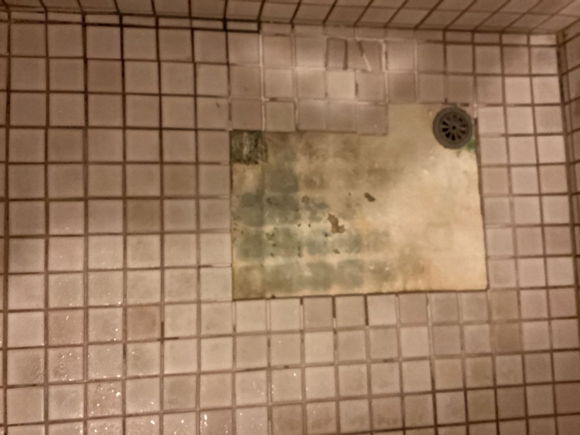

As a quick fix for loose tiles on shower floor,I would like to glue and grout with one product if possible,already tried but failed,adhesive would not harden and made only a mess,any suggestions would be appreciated,going to redo complete bathroom soon so not too fussy, thanks Glenn.image.jpg

I suggest using Dunlop Tile All for the adhesive (if you are only doing a small patch) and Dunlop Ready To Go grout

Used this product as advised…
wondered why the grout wouldn’t dry properly.
read the fine print on the label at the back of this product and apparently it’s not suitable for shower recess or wet areas.
having to now rip out the grout and tiles and redo with the correct products
please don’t make the same mistake

My apologies the product suggested was not suitable for your project. Thank you for bringing it to our attention - we will edit the post to ensure accuracy. I suggest instead using Dunlop Tile All for the adhesive (if you are only doing a small patch) and Dunlop Ready To Go grout
