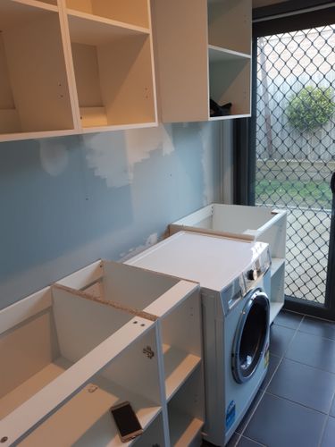

20200810_174308.jpgHi Guys.
My Fiance and I moved into our house at the end of the march. Have done a few small things such as replace some basins, and tapware and carpet.
Our first major reno is a laundry upgrade.
We have taken a lot of inspiration from @Jimi
Our current Laundry is below and next to where the photo is taken was a 900mm utlitity cupboard

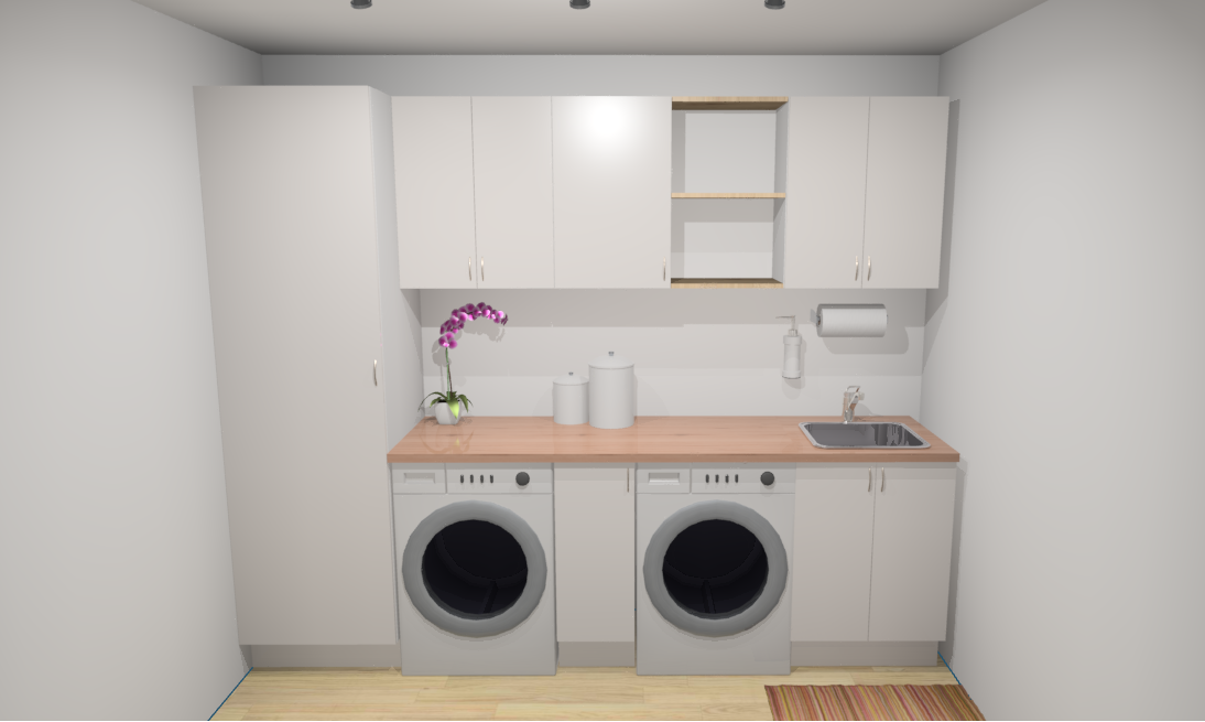

Our drawing is below. I hope it makes sense. The only difference on the plan is the last 600mm cupboard and floating shelves are swapping so that the 600mm cupboard will be above the sink and the floating shelves will be above the washing machine. Just to clairfy the 600mm gap next to the broom cupboard will be for a dirty washing basket and wet washing basket storage. The other reason for this is that when we sell the house in a few years time it means the new buyers can see the house and see that there is a potential to have a dryer in the laundry. We keep ours in the Garage as we barely use it.

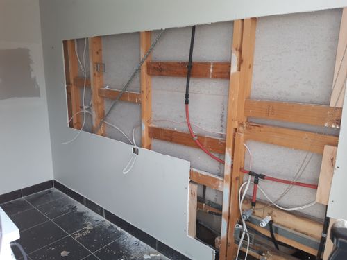

First Job was to relocate a light switch that was put in the incorrect position from when the house was built... Thankfully I'm an Electrician so this wasn't too bad. We have also built and put the 600mm broom cupboard in place.

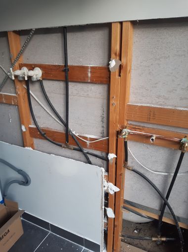

We will be getting a plumber in to relocate the water pipes to under the sink cabinet and this will involve cutting the wall sheeting away where the splashback will be going.
Our first question we are unsure about is can we get away with using Aquacheck plasterboard for the laundry seeing as it's not a true wet area or should we use cement sheeting. Also theres a big difference in price between the two.
Thanks in advance for any help and suggestions.

I thought I'd throw your design in the Kaboodle 3D planner and check out what it will look like. I think you're spot on there, this looks amazing.

Thanks for doing that in Kaboodle. It looks great and really confirms the decision we are making is the right one.

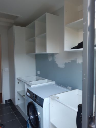

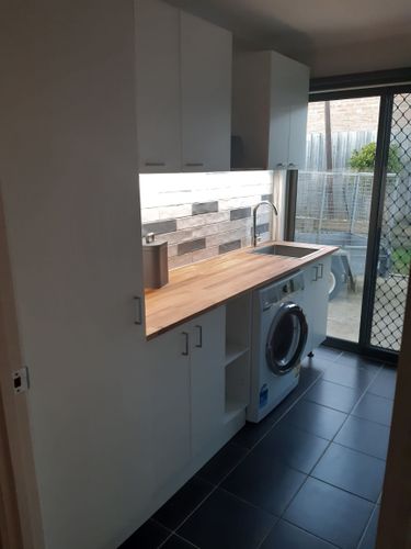

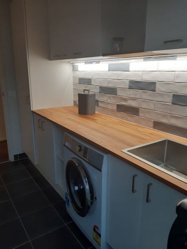

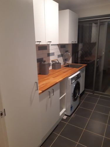

Just thought I would update this thread with a few pictures. Majority of the work is now completed. I just need to finish of the kickboards and install one more floating shelf but I'm off work for a little bit so it will give me something to do to fill some time in.
20200731_082900.jpg20200731_143320.jpg20200802_163250.jpg20200802_163308.jpg20200803_182606.jpg20200810_173523.jpg20200810_174308.jpg
Re: Bruce93's Laundry Reno
@bruce93,
That is simply amazing! Well done to you, you should be extremely proud of your efforts. I saw your finished picture and the first thought that came to mind was that you had posted some inspiration pictures of what you wanted to achieve. No, you had actually created it.
I'm truly almost lost for words, a big round of applause from me.
Fantastic work.

Great job. Love the wall tiling!
