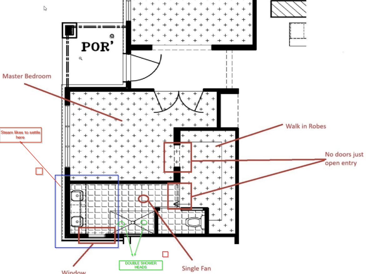

We have a double shower with 2 shower heads. Wife and kids love staying in there too long with the water really hot to create a sauna effect
We had just a regular exhast fan that only pulled about 300m3/hr of air ( those standard ones that builders supply)
The bathroom would have water running down the walls. This can create mould so I took out the fan and installed this:
https://www.bunnings.com.au/deta-250mm-high-capacity-exhaust-fan_p4441224
I think its better but I still see wet walls on the high spots of the walls. Which means also the ceiling is probably also wet

They usually have the door closed as its winter but the bathroom should have plenty of ventilation even without the window opened becase its the ensuite and has no door. You get to the ensuite from the master bedroom to the walk in robe
Here is a floor plan of it so you know what I mean. But we can try open the window a little. Mrs will complain though as she likes the whole bathroom like a sauna without cold air lolensuite floor plan.jpg

As @JacobZ suggested, preheating the room can make a huge difference in moisture build up as can a high-volume fan ducted to the outside not the internal roof space.
The position of the fan is also very important. They should be as close to the shower head as possible being the source of steam from the hot water. Often fans are placed away for cosmetics, but then are not working efficiently.

I just actually bought https://www.bunnings.com.au/deta-250mm-high-capacity-exhaust-fan_p4441224 and it works but still get some steam build up on the far left of the room andf I beleive its just because the fan location is not close enough to the 2nd shower head. ( check my edited floor plan )shower.pngThe ensuite where the shower is gets cold during winter as its next to the gargage with no heating and insulation + the front of the ensuite is facing the front of the house
I think id try install a 2nd fan but worried also about steam going into the roof. We do keep nearby stuff stored up there to but is about 2-3 meteres away from the exhaust fan. But still can mould be an issue in the long run with 2 shower heads?

Mould could always be an issue when you are pumping moist air into the roof cavity for it to condense. It would be worthwhile using the ducted vents, as you could ensure that moist air is being ducted outside, where it won't cause issues.
Two ducted vents, with one relatively close to the shower and the other one closer to the sinks, would be what I'd do.

Ill start off by installing another fan near the 2nd shower head towards the left side of the room and will duct it outside
