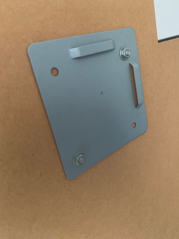

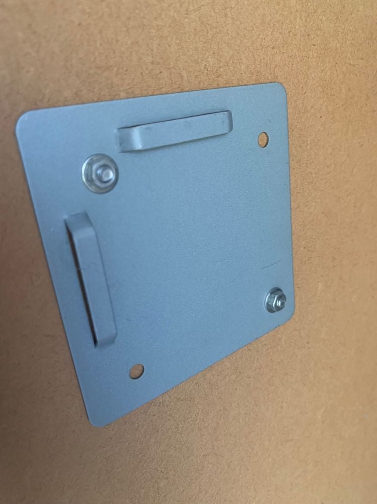

Just wanted to get some advice on fixing a mirror to my bathroom wall. The mirror is about 6.2kgs and will be hung on plaster board.
Any help would be awesome for how to attach it. Check out the photos of the hanging points.
They about 20cm or so apart.

I suggest having a quick look at this guide - How to hang just about anything by @Adam_W
I recommend looking at the following hooks that will work with your mirror plates:
Any of these three hooking systems will work very well with your mirror.

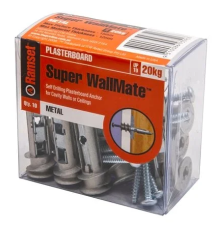

Everhang 20kg Heavy-Duty Solid Wall Picture Hanging Hook in combination with Ramset Super Wallmate Toggle Anchor
What screws would you recommend for the toggle anchors. The ones I had were to thin.
Cheers
Jonny
Re: Fixing Mirror to Wall
Hello @JonnyH
If you purchased the Ramset Super Wallmate Toggle Anchor you should find screws inside the packet. There is no need to get separate screws for the toggles. The screws that came with the packet are rated to work with toggles weight rating.
