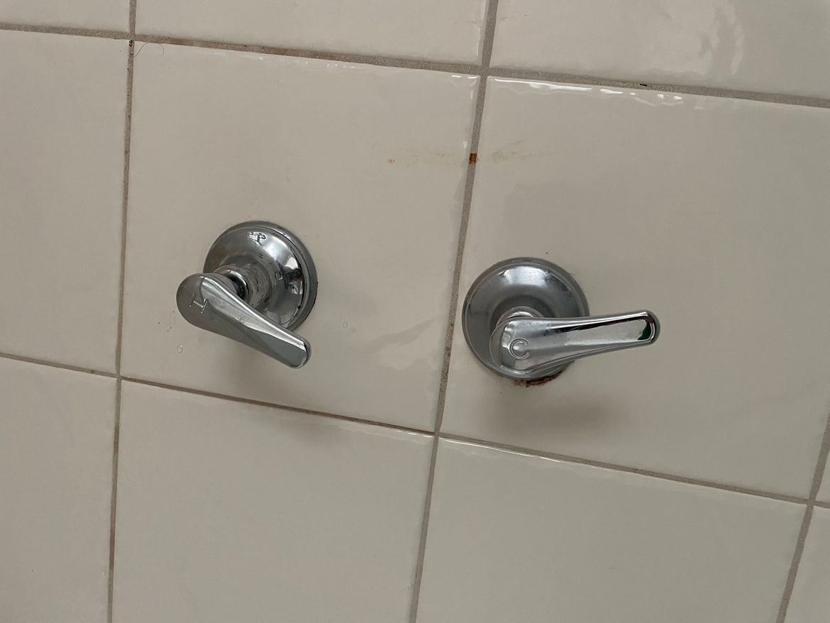

The bonnet can turn enough to leave approx 8 mm of spindle showing. I have included a photo
to show the tap handles. Does Bunnings sell replacements for these?
Hi @tigerzen
Usually taps like that have a allan key hole under the tap handle so please have a look for such access.
Once the handle is off the round bit on the wall unscrews you might need multigrips to turn them Please put some tape on the metal so the jaws dont slip and or chip the chrome.
After that with the house water off you will see a larger nut closes to the wall undo that counter clock wise take the tap off and take all the parts to bunnings and ask the plumbing section people help you select a size suitable replacment to reinstall may need some plumbing teflon tape to prevent leaks on an older tap base.
If this seams to daunting to do Please take your photos to bunnings they can help you buy suitable new taps and you can call a plumber to help you.
Hi Jewelleryrescue,
There are no allen key slots for this tap, we couldn't see any screw slots anywhere.
Ok @tigerzen
I believe you couldnt see any allen key holes. Some times they have caps over the holes but I think you would have seen them.
Eric will be able to advise better here he will respond tomorrow no doubt.
The next thing will turn water on to try this so try cold water first. Try unscrewing the tap handles probably anti clockwise fully open until they stop then try a little extra pressure and see if they unscrew off. To much force will break the metals. Beware!!! not to try go too hard as damage can occur in the wall causing an expensive repair If you feel uncomfortable with this wait for Eric Tomorrow or some one who knows those taps with first hand info.
Be gentle helps coming
Hello @tigerzen
Welcome to the Bunnings Workshop community. It's splendid to have you join us and thanks for sharing your question about removing your shower taps.
I suspect that this has a hidden brass locking nut hidden behind the handle. I've placed an image below to give you an idea of how it is attached. You'll need to use a Kinetic Spout And Handle Repair Kit, in the kit you'll see a flat bladed tool with two prongs pointed up. This tool fits in the back of the tap handle and you'll need to turn it anti- clockwise to loosen the brass nut.
I also suggest having a look at this guide: How to replace a tap washer
You'll notice in step two with the tap head displays, there is one with a hidden fixture behind the tap handle.
Thanks Eric for the illustration and advice. I have felt behind the lever tap and can't locate any small slots for the wrench to fit into, assuming there aren't any, is there another way to get the lever off so I can change the washer. Also, because this is a half turn lever, does this operate on a ceramic cartridge rather than the standard tap washer that you have referred to?
Hello @tigerzen
Can I please ask you to take a photo of the side and back of the tap handle? It's possible that the locking ring is recessed deep inside the back of the handle that's possibly why you can't touch anything. I suggest getting a picture of the back to give you a better idea of what it looks like.

Hi again Eric,
It was next to impossible to get a decent photo but your Kinetic kit did the job, there was in fact a retaining ring holding the tap in place. Once I got it off I discovered that the taps had cartridges and I replaced the existing taps with more modern taps. Thank you for your help.
