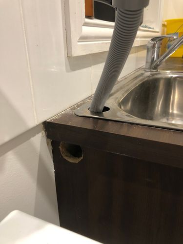

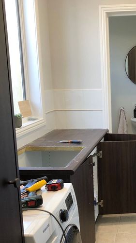

First time undertaking a serious renovation - would love some advice. I’m hoping to get the bench top off without damaging tiles or plaster. Clips to cabinets have been removed and grout removed under tiles but it still seems well held in place by silicone to the wall behind.
any suggestions for an easy way to remove while minimizing any damage?

Have you checked whether there any fixings from the bench top to the cupboards underneath? If you look underneath, sometimes there’s some bench top joiners. Also, check and see if the cupboards have been attached to the wall at the back - sometimes people do that, especially in a Laundry where the slope of the floor makes it difficult to level cupboards.
Next, is the wall a gyprock wall or a solid wall? If you’re not sure how to tell, tap the wall - if it sounds hollow (drummy), it’s gyprock, if not it’s solid.
Next - without more information about what you actually want to do, the only further wisdom I can offer you, is that you’re likely to cause REPAIRABLE damage when you have a go at the bench top, so don’t be scared, cheers Deb ![]()

You mentioned that the clips have been removed holding the benchtop to the cabinet. If it is still attached you may need to carefully run a knife in between them as silicon may have been used to hold it down also. Presuming the benchtop is now not attached to the cabinet, I would try picking up the front edge and gradually lifting it. Lifting the front will start to pull away at the wall, the higher the angle the more it will pull away. I advise this method, as prying it at the back away from the wall will cause damage and the adhesive or silicone is just too strong. It appears you may have already tried this from the photos.
Lifting from the front provides a lever-action force to the rear where it is attached.
