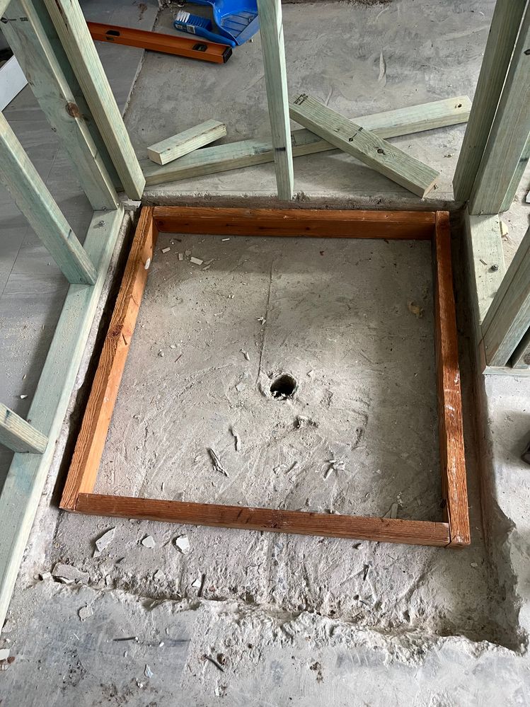

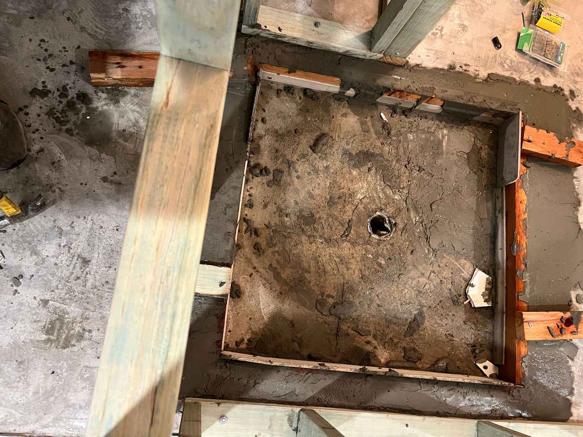

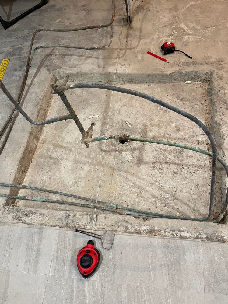

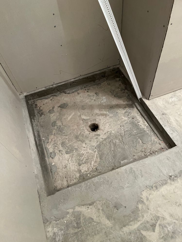

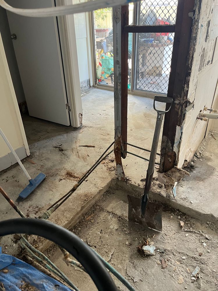

i posted a question regarding framing the other week and recieved some great help, thank you. now i am measuring and locating where the new wall will go and i see the recess in the concrete overlaps the location for the new frame about 40mm. also the recess for the shower is very rough and not square, it is just over 1000 long and wide with rough edges and varies in depth 70 - 90 mm deep.
obviously i need to reshape and fill this "whole" can you suggest how ? should i build a square box and center is and fill the outside with grout or concrete or something else? and what about the base or floor area, surley that will require rendering with something
here are some pictures, i hope you can help oh ftu the copper pipes will go and i will re blumb with PEX. thank you

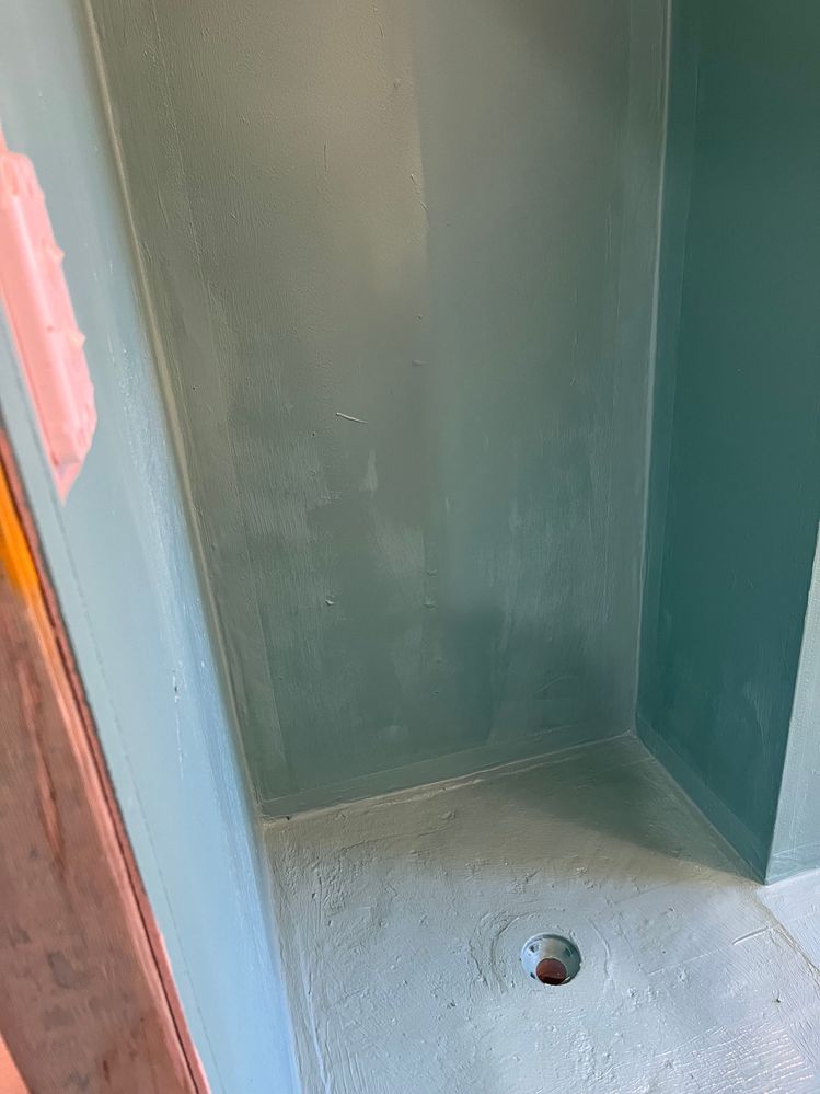

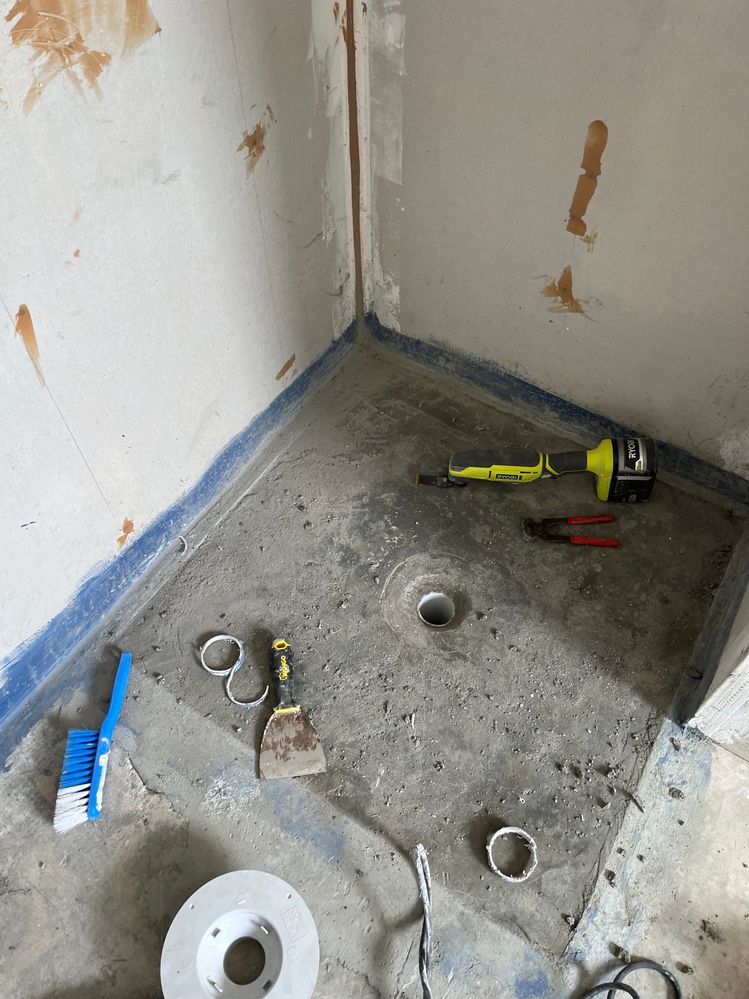

thanks for your help, my next question regarding the shower base, as you see it requires screeding and water proof
which is first ?
thanks again
i have a price from a local tiler who can screed and tile for 3300$IMG_1488.jpgIMG_1489.jpgIMG_1600.jpg
Re: shower base
Hi @Sedg,
According to the National Construction Code Part 10.2 Wet area waterproofing, specifically Part 10.2.21 Membrane installation for screed -
"Where a screed is used in conjunction with a waterproof membrane, the waterproof membrane can be installed either above or below the tile bed or screed."
Essentially, your waterproofing membrane can be applied either above or below the screed, or both if you want that extra peace of mind.

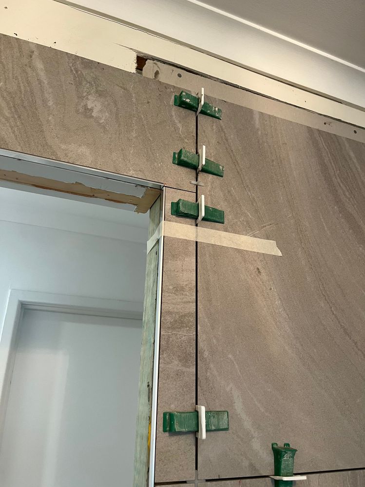

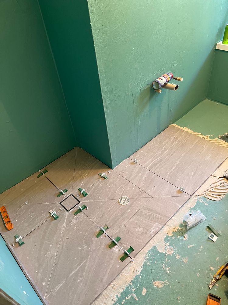

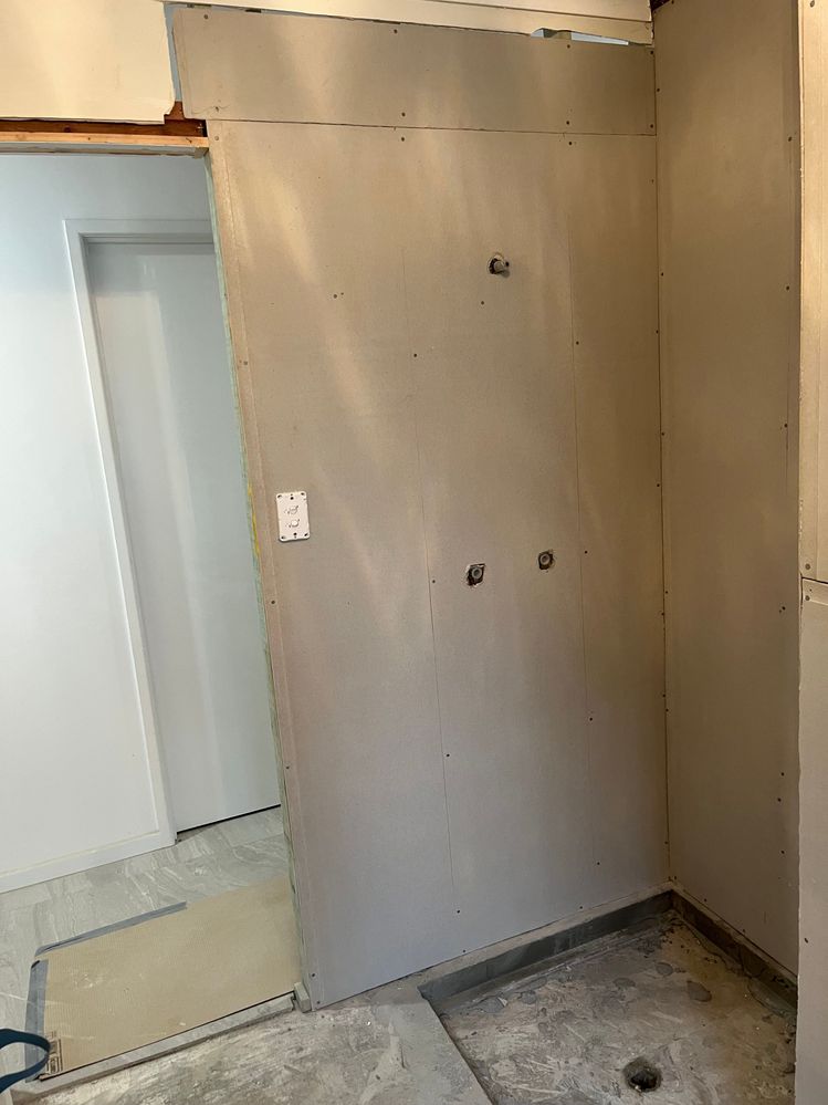

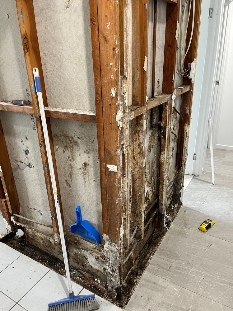

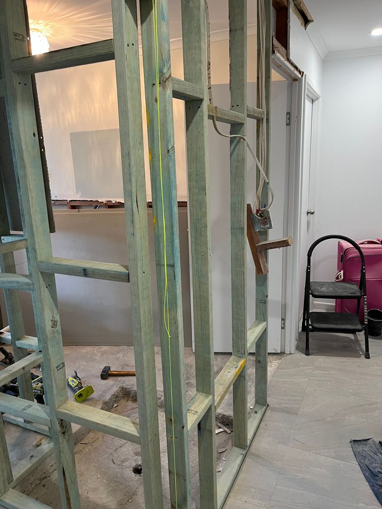

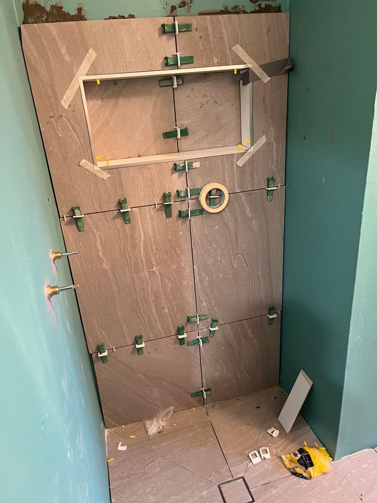

as you have been a great help to me I thought i would brief you on my progress
attached are picture before , during and now
I did bring in a professional tiler to do the water proofing and tiles, everything else i did alone
note we waterproofed below and about the screeding. more tiling to go, the laundry and toilet have also been prepared for sealing and tiling
i will use shark bite plumping for the shower, ive install new breech and tap assemblies.
thanks again for your help, i will show you the finished article soon

Hello @Sedg
Thank you very much for sharing those photos of your bathroom renovation. Its looking good and your making great progress.
We look forward to seeing the bathroom when its totally finished.
