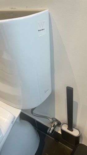

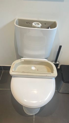

We have a toilet that seems to be of the ‘watermark’ brand. Every time after we flush it, it continues to drip into the toilet bowl. I’ve turned off the water at the cistern tap to see if it still does it but it stops dripping into the bowl when I turn it off.
What do I need to do to fix this and what parts are suitable?

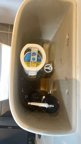

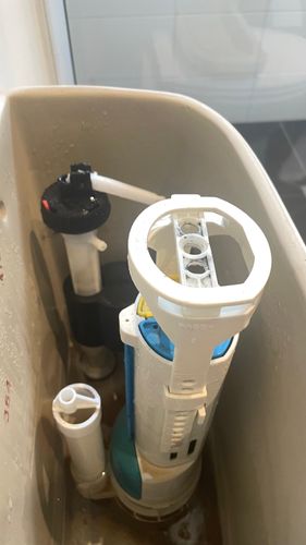

Thanks for sharing your question about your leaking toilet. Since you've narrowed down the symptoms, odds are the inlet valve is leaking. If the flushing valve was defective, you would still get a leak but since turning the tap off the leak has stopped.
If you are familiar with how to repair your filling valve, it would be just a matter of replacing the inlet valves washer. However, if you're not confident with repairing it, I suggest engaging the services of a handy person or a plumber.

Also it seems when we give the top of the cistern a little nudge on the side when it leaks, it tends to stop!

To access the valve washer the black cap on the inlet valve needs to be removed. Sometimes they just pry off, or they can require a quarter turn to release and to do so the link on the white arm might need to be undone. I note your cap has a suspicious red section, which might need to be disengaged to allow the cap to turn.
The kind of washer can vary from toilet to toilet, but it will be very similar to this one Fluidmaster Toilet Inlet Valve Replacement Seal.
