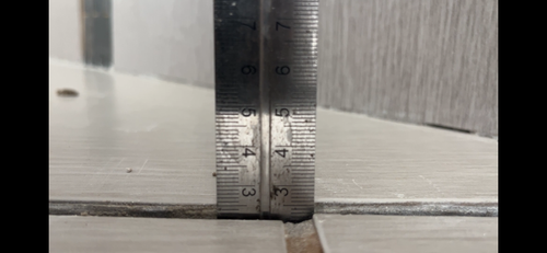

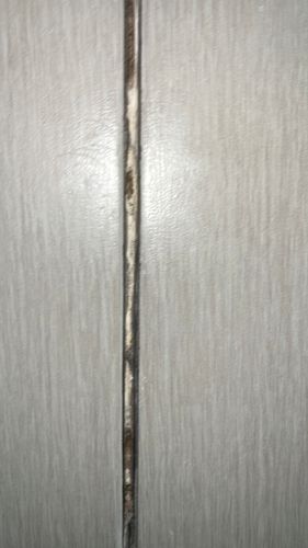

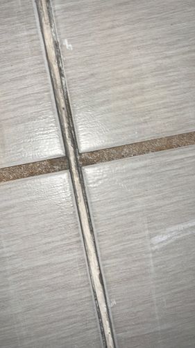

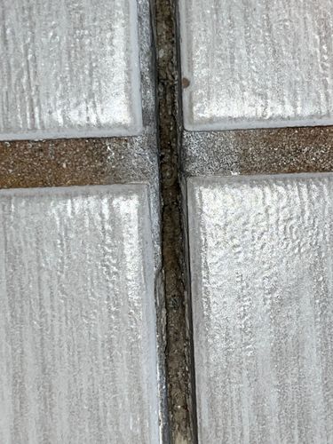

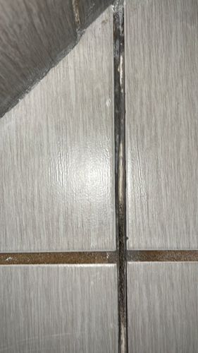

Hi all,
I’ve been removing the old grout from my shower floor to re-grout it. Some of the old grout was pretty soft and crumbly, so it came out really easily, but now I’m worried I’ve gone too deep in places, up to 20mm (you can see in the photos).
Do you think this depth is an issue? Any suggestions on how I should proceed before regrouting?

Hi @Josh86,
It is hard to say with 100% certainty, but it doesn't look like something I'd be too concerned about. You would notice the difference when going through softened grout and then hitting a solid fibre cement sheet or concrete.
When you say deeper than you thought, how deep are you talking?
If you grab a ruler and stick it in the deepest spot, how deep is it?
Is there anywhere you can see the edge of a tile to gauge how thick they are?
If the ruler goes deeper than the thickness of the tile, plus about 10mm for tile adhesive, then there might be cause for concern; however, looking through that tile gap, I see what looks like tile adhesive rather than a waterproofing membrane, which makes me think you haven't gone too deep.
Allow me to tag our experienced members @Dave-1 and @Nailbag for their thoughts.

About 25mm in this deepest spot. I can still scrape out a wet sandy substance when I stick the steel ruler in that spot.
