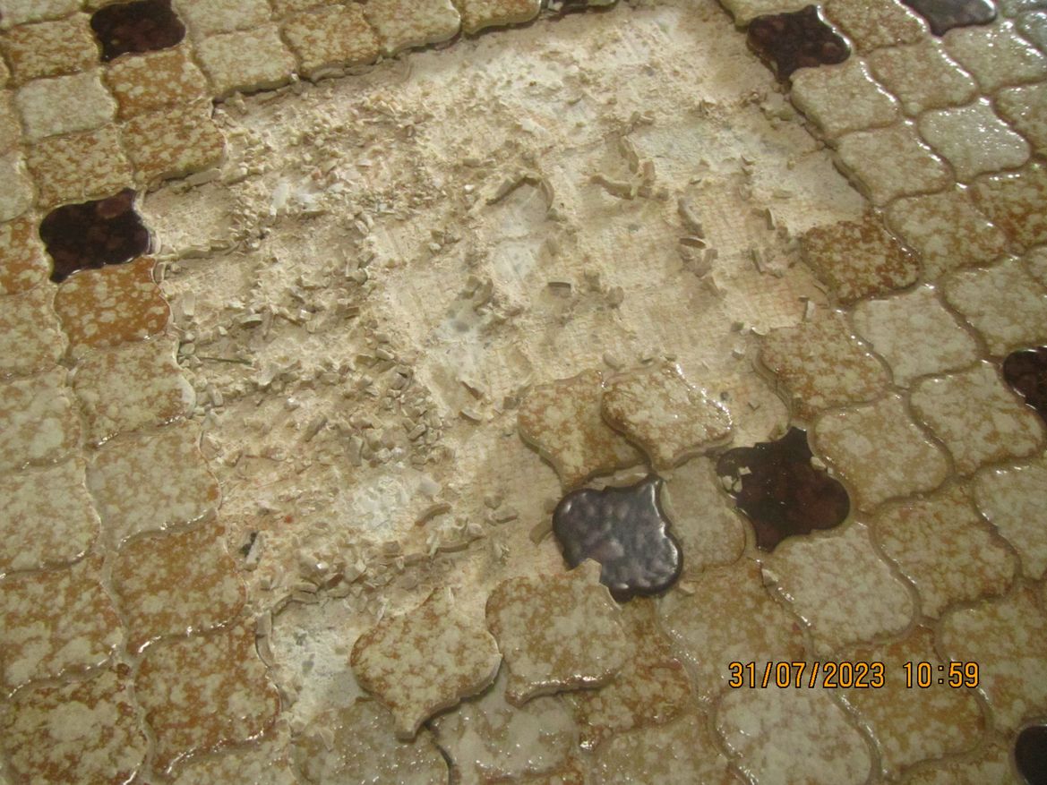

I have an area in the laundry where the mosaic tiles have tented and some have already lifted off and come free. How can I fix it? Should I get it professionally done?

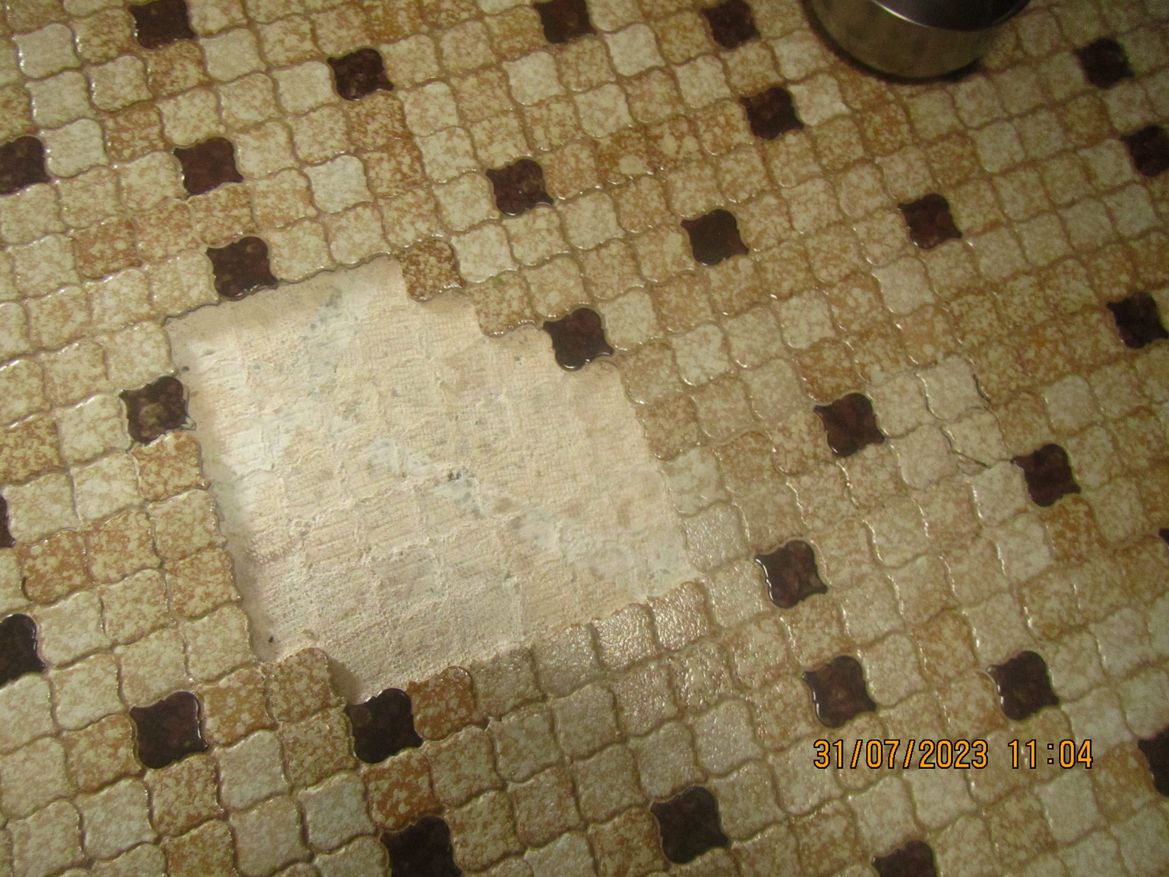

the tiles are floor tiles, not wall ones. Some of the tiles around the original area are now comming loose as well. This is a well used area.
I (hopefully) have uploaded some photos. A friend of mine told me about a product called 'Fix a floor', however, apart from getting it on-line and how good it would be for small mosaic tiles, I have no idea.

Thank you so much for posting photos of your flooring. Just to add to the suggestions @MitchellMc has made, I recommend using a Trojan 6 In1 Multi Paint Scraper to scrape off the old adhesive on the floor. It might take you some time to remove it, but it will eventually come off.
Once the area is clean and flat, I suggest vacuuming off all the dust and debris before you begin your re-tiling repair.
